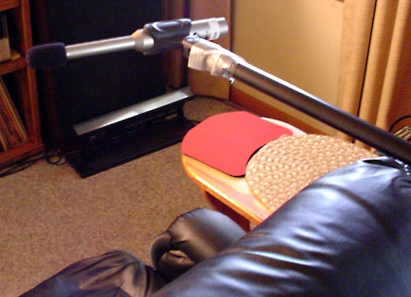

I use a mini boom stand for guitar mikes.
That sits on a shelf behind the comfy chair, and I adjust and angle the mike as needed so it's placed right in the sweet spot. I use a Dayton mike, and find that I can get more accurate results by swinging the mike towards the speaker as I graph each channel, then straight forward for the final tweaks.
Oh. And I've since replaced the duck tape with a genuine threaded connector. <G>
