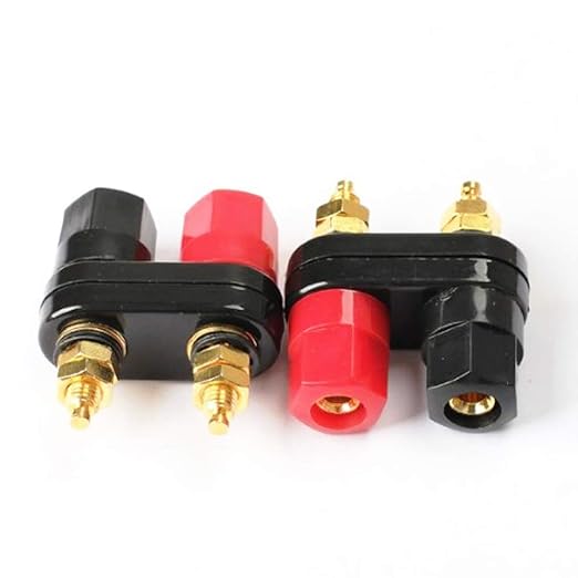

If you decide to put in new binding posts while you're in there plan carefully to make sure everything fits. I put five way posts on mine and had to flip it upside down to fit without touching the woofer frame and did not want to rebuild the whole thing at that time. (my soldering skills were are still evolving) I'm pretty sure many here would tell you to not bother with the binding posts but I put them on for consistency with my other speakers.
Hmm, which posts did you use? The depth of the woofer is only about half of the cabinet, so you must have used some rather large parts. I was thinking of using these:
https://www.amazon.com/Eightnoo-Connector-Binding-Amplifier-Terminal/dp/B01N6MCK0E
My bad, it wasn't the woofer. I had to flip the three pole switch over on the board because the back end of the new binding posts were in the way. I used the type where they are set in a plastic yoke such as
Essentially I planned my layout poorly, so my normal and extended are now reversed.
