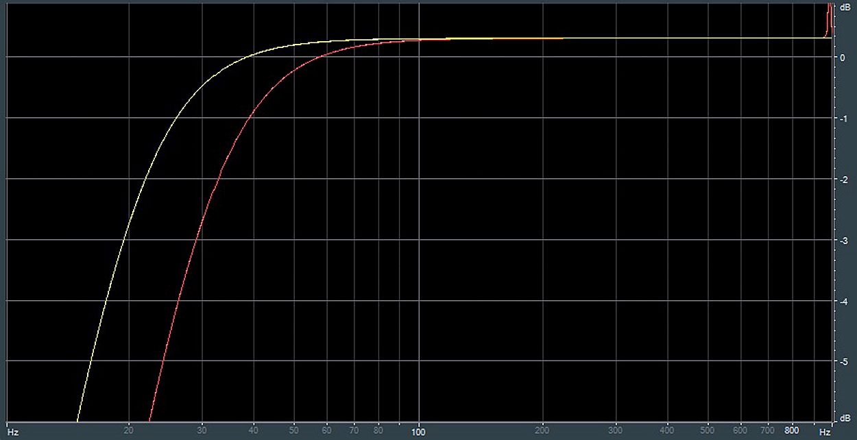

It seems to have an overly aggressive rumble filter. It starts rolling off at a whopping 250 Hz, and by the time it reaches 30 Hz it's already at -5dB.
I guess this could be perceived as a "lack of bottom end".
But it's fine without the filter.
Schiit SKOLL Phono preamp stage balanced MM frequency response measurement.png
For comparison, here's a properly implemented one:
Cambridge Audio Duo Phono Preamp stage MC MM Frequency Response RIAA EQ Measurement.png

Looking at the above graph, the frequency response without the rumble filter is perfect. It's pretty much textbook stuff.
However, the filter looks worrying and does seem to explain why one might find the bass a bit lacking with it activated. Maybe you're not using the filter?
That graph can't be correct. There would be a tremendous loss of bass response. :idea:
The roll-off should be steeper in angle and start at a lower range. Rumble is in the low-to-subsonic frequency range. Like 30Hz and lower.
Right?
Yes, that's how it should be. But ASR says it isn't.
Now, of course it's not impossible that Amir made a mistake in that test. I can't vouch for its accuracy. I trust Amir, but he's human, too, and mistakes do happen. I'm just reporting what I've found. :angel:
But if some people find it a bit lacking in bass, then this might explain why.

Rolloff beginning at 250Hz? Might as well not have a woofer. Well, not a good woofer. That's 6X9 range. :idea:
