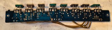

The worse thing was end transistor board that was compleatly broken in half.

Transistor board I epoxy glued back together and used juper wire to connect traces again, no trustin for glue and solder, so now-on it two boards, if they seperate in future, it does not matter.
I drilled exsisting holes bigger or middle of two components for the wire.
