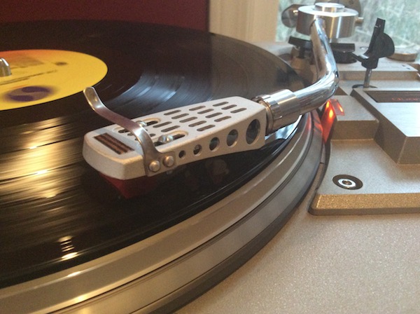

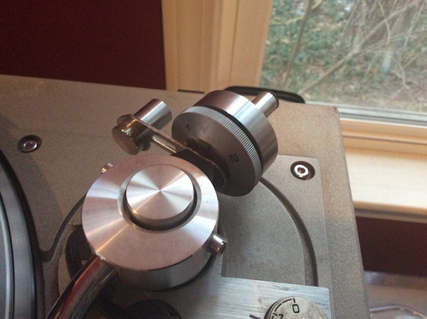

Here's a shot of the cartridge and counter weight I have (any idea what the cartridge is?). Neither look to be factory according to that earlier pic. I can only estimate but it seems like I can only get about 1.5g of tracking force before I hit the end...which honestly seems to work just fine so far.
(sorry for the awkward images, still learning best way to post them here)
Can't see enough of the cartridge to ID it (but it might be a Sanyo/Fisher MG-29. If you were to take a shot of the cartridge with the headshell removed and with the cartridge facing up, we can get a better look.
The headshell is an inexpensive aftermarket one, readily available all over the internet. (Someone apparently decided to "modify" the finger lift.:eek:) It weighs about 6.5 grams or slightly more. The Pioneer headshell is heavier. I can't remember exactly what it weighs (if I ever knew) but I'd guess 8 grams or slightly more.
The counterweight is the correct one for the PL-540.
