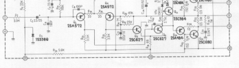

Hey all,
So after full recap and all new transistors this Pioneer SA-1000 keeps burning R1 330 ohm on the power supply board. (You can see the toasty resistor in pic) I’ve double checked multiple times all transistors oriented correctly. Caps oriented correctly. I think I might have a ground short somewhere because pin 13 is grounded out and 14 for that matter. Any ideas? Thanks!

Can you move the cap that's tied to what looks like a terminal strip and get it off the pins of that other board? I know it has a sleeve over the metal can (UPW?), but does it need to be resting on it?

The large blob of solder above the capacitor by the resistor looks suspicious. Now look at the bottom side trace paint markings. The bottom orange wire goes to the trace that follows above the horizontal diode to the positive side of the single electrolytic cap and the other 2 diodes and ceramic caps. The black wire (#12) goes under the resistor and diode then above the single electrolytic cap curving down around the two electrolytic caps to their positive side. The red wire (#13) goes under the diode, to the resistor then past the solder blob to the negative side of the 2 electrolytic caps. The orange wire (#14) goes to the diode cathode side and thru to the negative side of the single cap and the resistor. Without looking at the schematic, I believe that the two electrolytic caps on the fer left are backwards. I base my opinions on normal wire color code conventions where the red and orange will have a positive potential and the black wire should have a negative potential.

Look at the full schematic at the PS board. You will see that pins 1 & 12 go to ground. Capacitors C8 & C9 from pin 1 (GND) are shown correctly with the negative side of the caps to gnd P1 but the caps C3 & C4 are shown backwards with the positive sides to gnd P12. C3 & C4 need to be reversed to stop nuking the resistor. I would check them first to see if they are hurt or just replace them when you get another resistor.
EDIT: Well I see why they are like that. I downloaded the manual so I could blow it up and pin 13 is -45 volts and that would make ground more positive and that is why the caps are reversed for C3 and C4.
Pin 13 feeds pin 23 on the amp board. Check the amp board for shorts in that part of the circuit. Also ensure that D5 isn't shorted . ..

Pull the wire from 13 and see if the situation changes. It should have no current draw worth talking about with it off but lets confirm.
Also can you give us the voltage drop across the 330 ohm resistor?
