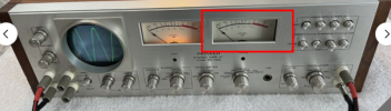

I would like to ask for some help from any owners of the Pioneer SD-1100 audio scope unit.
In the unit I just purchased (so excited) one of the VU Meters lamps is out.
While I have downloaded and searched the service\owner manuals there is no mention of which type or model for lamps...
If anyone knows and would like to share please do :)
Thanks in advance,
Barkai
Ask Dave if he knows about your device meter lamps. He may even sell them. dwojo69@msn.com
Those meters look like the same ones in the CT-F cassette decks. They used a leaded 8v fuse style lamp.
The scat shows a 7.5 volt AC supply.
