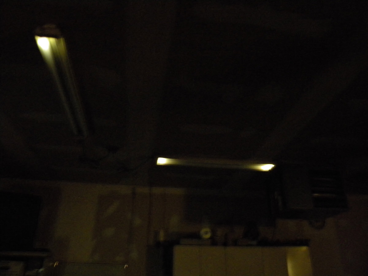

But if we were to experiment with such a device, we might find that at some moderate output power, with a vertically-polarized ground plane antenna in an undisclosed but nearby location, sufficient energy might be imparted upon surrounding equipment to cause this sort of phenomena:
Yikes! You don't sit in that room and drink your beer, do you? I mean, your beer would get warm pretty quickly! Who needs wired fluorescent tubes when wireless will do just fine!
