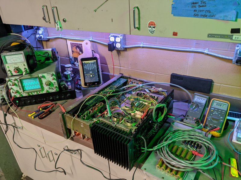

Working on an sx-1280 now.
Sourced the njw1302g/3281g replacements as called out by @markthefixer.
Will post back when I get them installed and the output stage re-biased.
Would like to go with MJ15024/25's as they are proven workhorses, but the retrofit would be much more complex.
Media post shows the working left channel pumping out ~240 watts rms.
Cheers!
MJ15024/25's in to-3 metal cans? how the heck are you going to mount them? stick with what has been proven to work.
Why? They have nowhere near the transition frequency of the originals and are not a good match for the amplifier design, the 3281/1302 are so much closer to what the original transistors and much easier to fit.
THAT would be a mistake. As kevzep points out, they have a Ft (4 MHz) that is slower than the replacements (30 MHZ), and the originals (15 MHz) .
Yikes!
Slow down gents.
Replacement parts are in route as stated.
And the to-3 idea shelved as well.
The Motorola's are stocked and gain matched for commercial amp repair....to-3 sockets as well.
Heat sink mods for these guys are not that difficult, except in this case.
Rest assured, this fix is following recommendation. Thank you.
