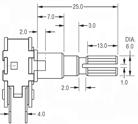

Hi i need an info.I have a pioneer sx 650 with a broken treble pot shaft unfortunately i live in italy so shipping for a pot on ebay is 40 dollars.I want to know if is possible to change the pot with a "normal" 100k dual linear pot that i can find locally thanks.I could repair the shaft I saw few thread on this side what it would be better to replace it thanks

hi the problem is not finding the original pot the problem is that shipping to italy cost a gazzilion dollars so was trying to understand if I can change with a normal pot

A "normal" pot will work. However, there are about 50 varieties of "normal" so you need to select one that will fit the installation, have the correct length and diameter stem, and PCB mounting pins.
Verify the length of the stem.
This is typical on a 750, likely the same:
