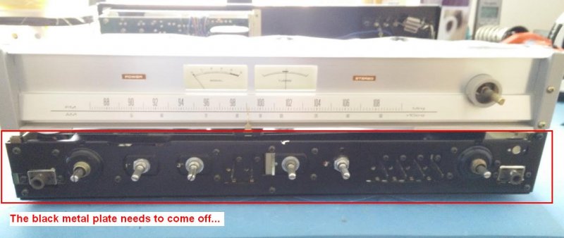

Now you should have your faceplate off and here is the tricky part. Removing the black metal plate need a bit of patience and delicate hand. After removing all the screws that hold the black metal, you need to gently pull the tuner string in order to free the black metal plate.

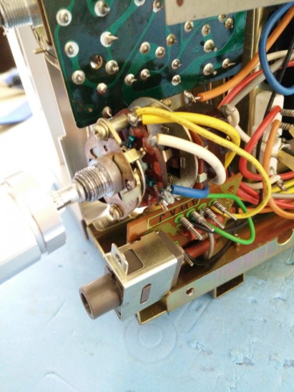

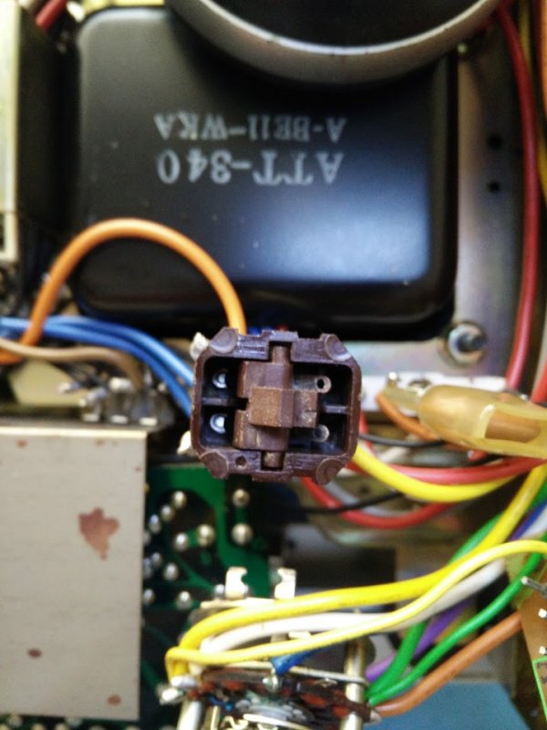

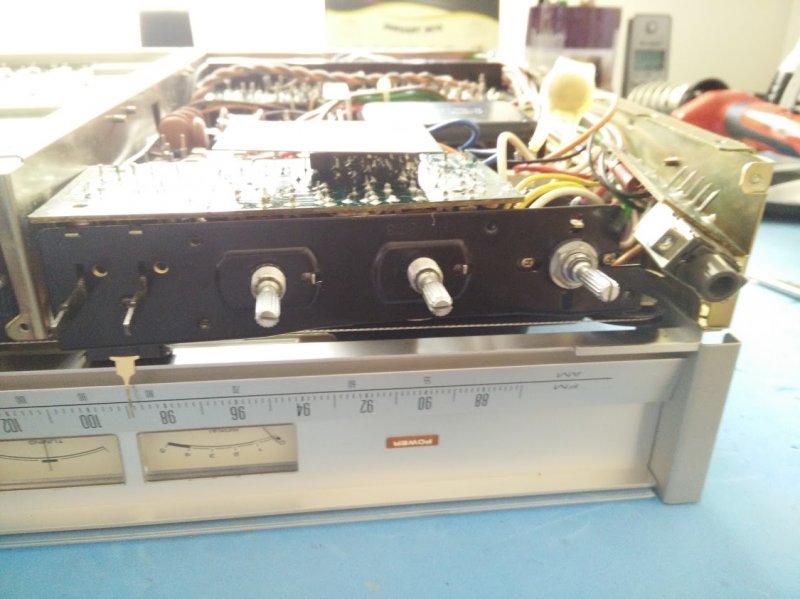

Black metal piece off

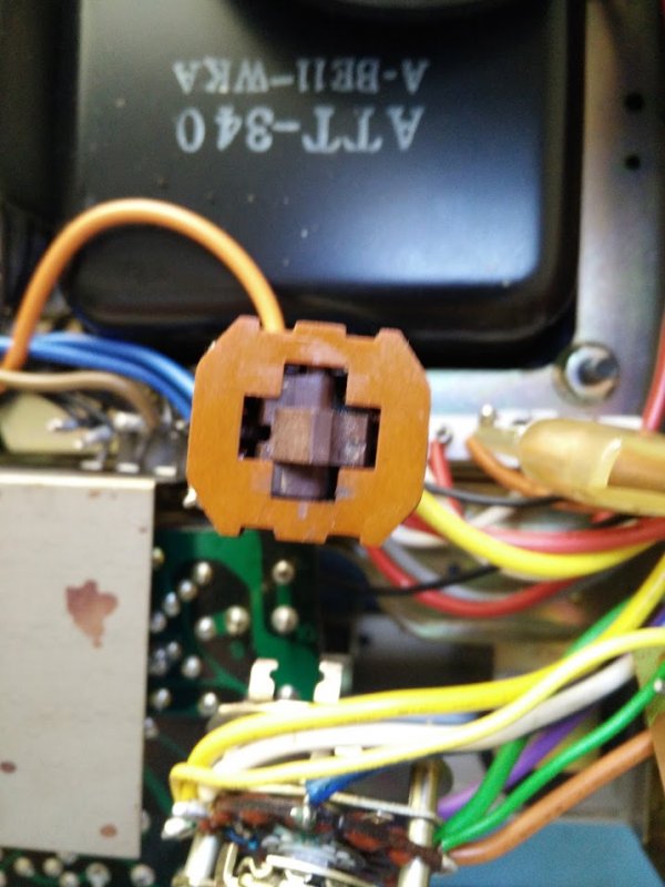

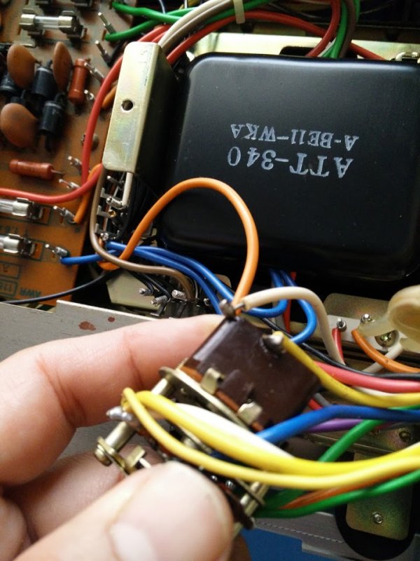

With the amplifier upside down, it is easier to access the switch now.

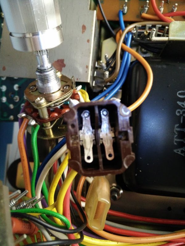

Remove the switch cover
The cover is hold by metal clip on four side, just need to straighten them to remove the plastic...

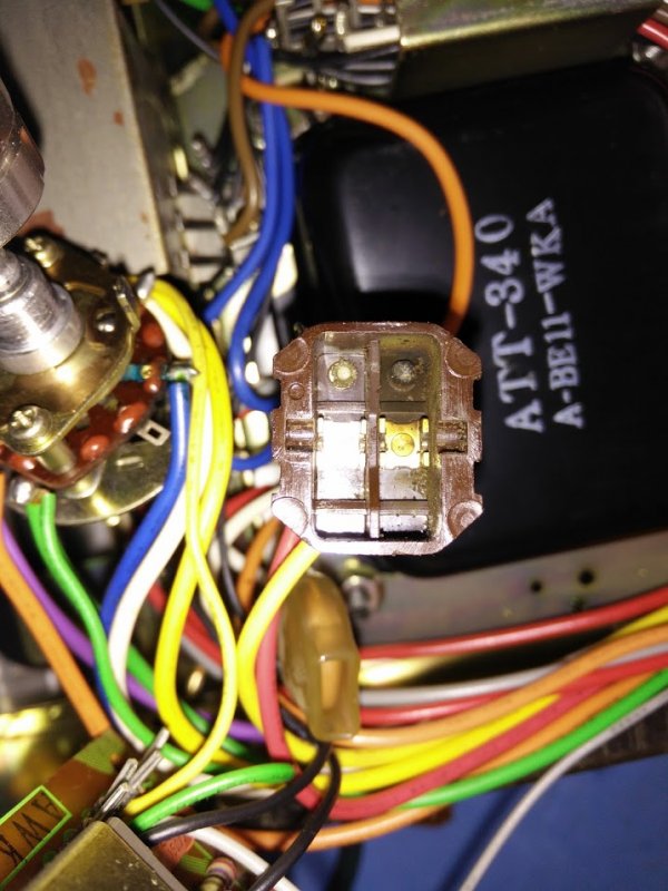

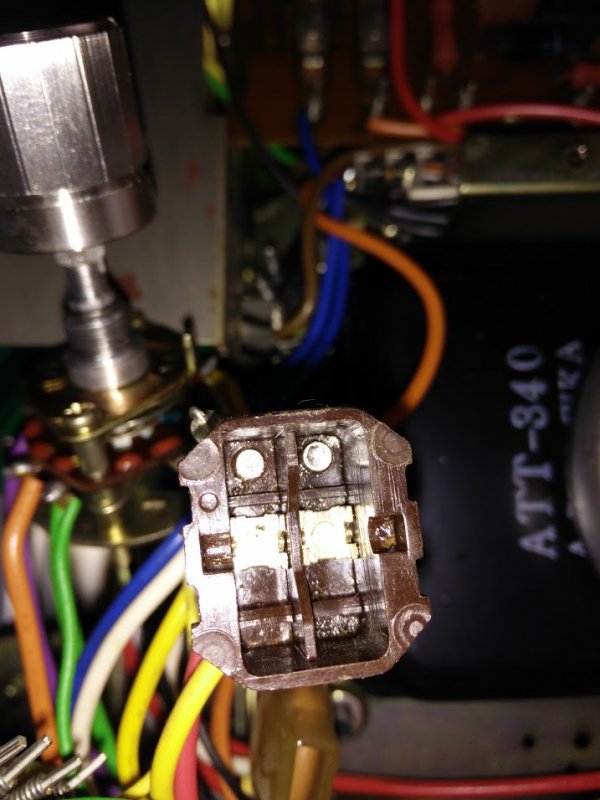

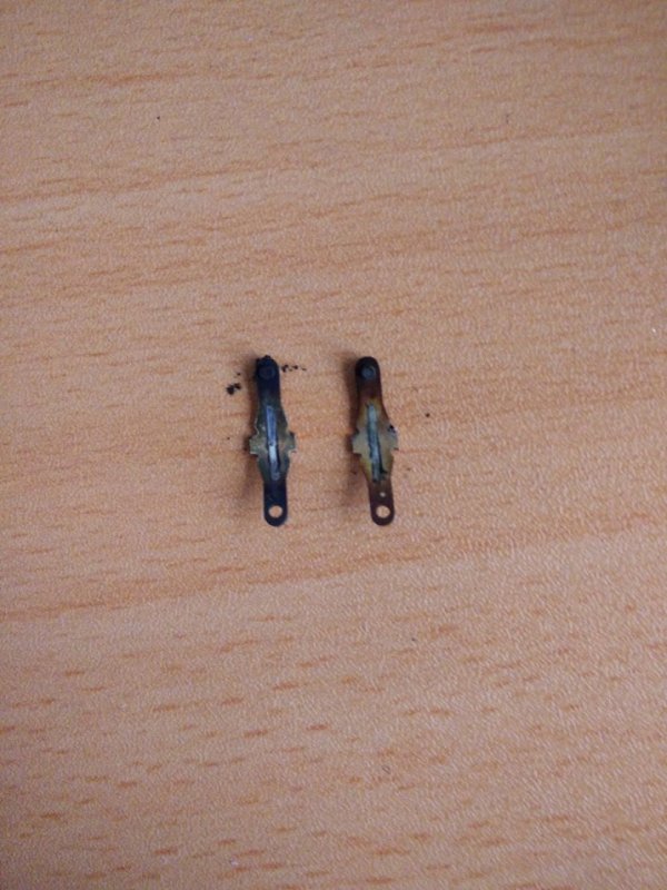

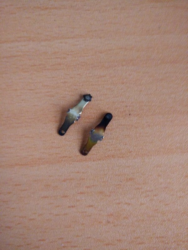

Carbon built up
This is how it looks like for an unclean switch, check out the amount of carbon build up.

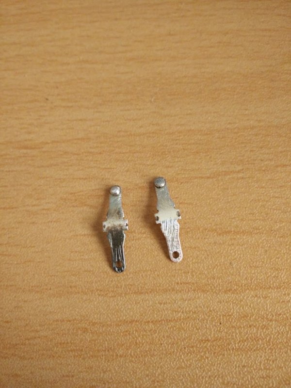

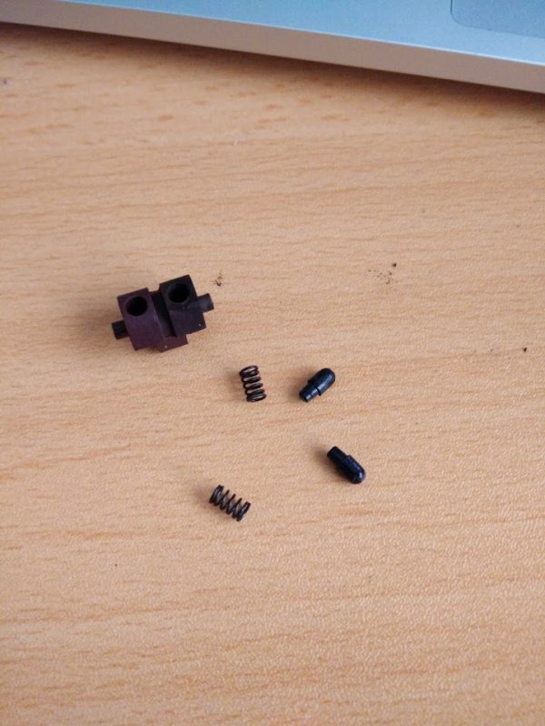

Plastic gasket back in place
Make sure you have the plastic gasket back in place before putting the switch cover back.

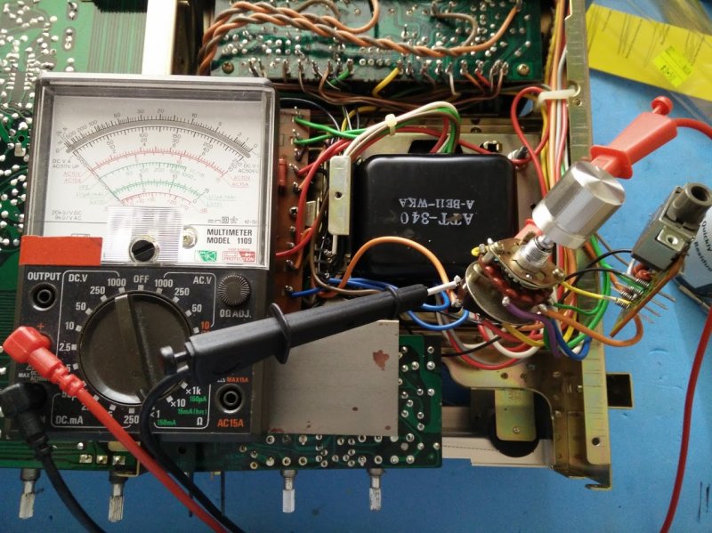

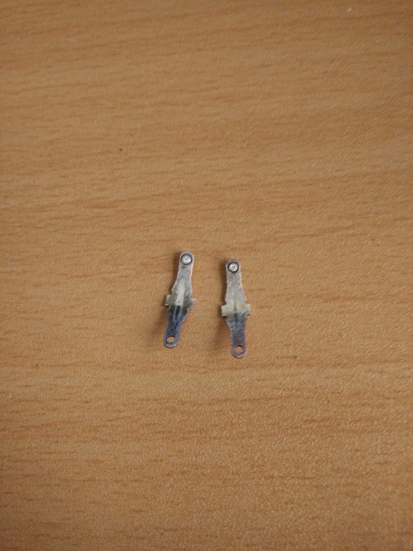

Test the switch with multimeter
Before putting it all back together, it is good idea to test the switch with a multimeter, there...
