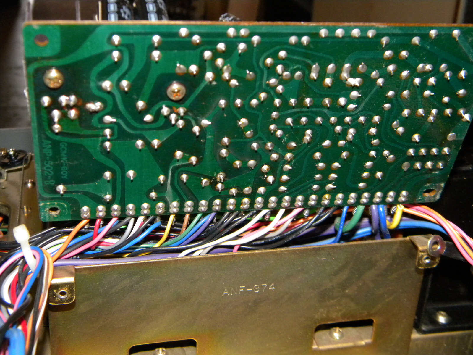

I just recently purchased a Pioneer SX-5560 (SX-750 in black) and it has the hum issue that seems to be fairly common in these models. After reading some threads it looks like there are some capacitors that go bad and need to be replaced in particular C17 & C18.

Do you guys think its worth it? How difficult would it be to install the kit? Is there an easy way to get to the underside of the power board without disconnecting a lot of wire connections?

I'd bet a nickel that the power supply caps are failing. Most of the 750s I've been through had already developed hum or were on their way, not to mention other supply-related problems they can exhibit.
The "kit" on eBay may be a good start, but may not be ideal. Get the recommended appropriate replacements from a reputable distributor, along with a few other minor items, and repair it properly. To do it properly, you will need thermal paste, probably some mica washers, and potentially other supplies and hardware. You may also need both rectifier and Zener diodes, which don't appear to be in the kit. The price for that "kit" is not unreasonable, but the two larger caps included really need to be different from what is supplied. If you have doubts, the following is why we change things such as this.
The unit was designed to operate at a nominal 117VAC when it was sold (KC/KU types). The power supply that is filtered by those 330µF/50VDC caps was originally 48V. As if that were not already dangerously close to the WV rating of the caps, most utilities have been increasing voltage over the years to help stretch the distribution systems. 125VAC is very common today. If you do the simple math, that 48VDC circuit is already probably at or over 50V (51+). They need to be 63V caps at a minimum, and bumping them to 470µF is not a bad idea.

The regulator for the 37V supply operates hot, and can benefit greatly from a clip- or bolt-on heat sink, something which doesn't appear to be included.

As for the ease of access, the board only needs to be removed from its mountings, It can be swung up and into full exposure without disturbing any wrap connections.
Incidentally, if you zoom in on that photo, you can see about halfway across the bottom of the board a solder pad which has begun to disconnect itself. I believe this should be sufficient evidence that Q12 can use a little heat added sink.
Thank you. Now that is exactly what I wanted to know and the picture makes it perfectly clear. :)
