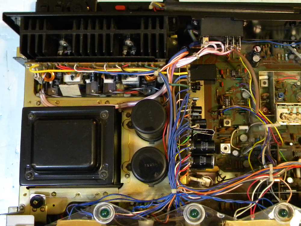

So the relay has arrived, while I was recapping the tone control board.
Now... someone before me has tinkered with the power switch circuit and oh boy...
One of two brown wires coming from the AC inlet goes to the switch, the other straight into the transformer.
I really want to do this right, clean up this mess and install the relay.
@Watthour or someone please tell me how to open the switch and how to fix the wiring. I could do it if i really tried but I’d rather ask the professionals.
So I wired up the relay, I’m 99% sure that I’ve done it correctly.
I fired up the amp on a dim bulb tester, and the relay made a “crow-like” crackling sound. The lights turned on and off and on ágain érc and the dbt did the same...
I immediately turned it off. What did I do wrong?
You're right on the money with that. The relay is likely chattering from insufficient voltage. Get off the DBT and I'm guessing it will go right. I've had the same thing on a few that I've converted to power relays.
