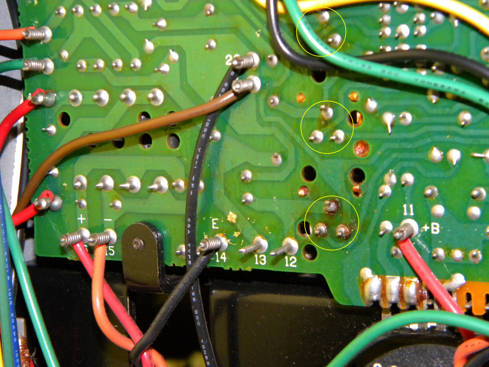

With no activity from the tuner, the secondary power supplies are in question as well. Check the three regulator transistors, Q19/Q20/Q25. They are reputed to have connection problems.
