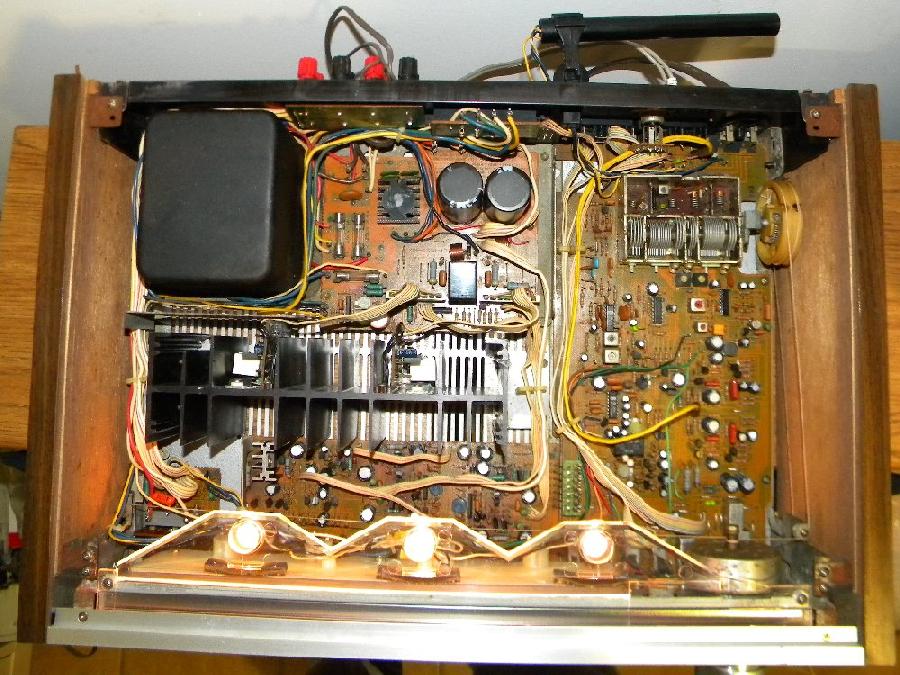

Hello All,

Anyway, I got it home, hooked it up and powered it on. Lamps were flickering and would completely dim out after about a minute. Toggling the brightness button on and off would restore the lights but they would gradually dim after a minute to the point where the unit appeared to be off.

While inside I checked connectivity of all the internal fuses and they were all ok. The one thing I did notice was one of the diodes on the board (right near the center) had 'grown' two very fine hairs, that when the unit was upside down were standing straight up, but I imagine this is a cracked diode? Could this be a problem? I have included pictures and you can see one of the hairs as a very fine black line over some white wire insulation.
Anyway, my question for the experts, where should I troubleshoot next? My background is in computer engineering and I'm pretty handy with the soldering iron and diagnostic tools so you can talk techie to me. :)

I can not see the fine hairs in your pics
Do you have a proper FM antenna, min a dipole or rabbit ears etc
View media item 16414Above should be the link to the picture with the cracked diode, if not it's in my only album on my member profile, you can just make out the 'hair' as a black line in front of the white cloth insulation.

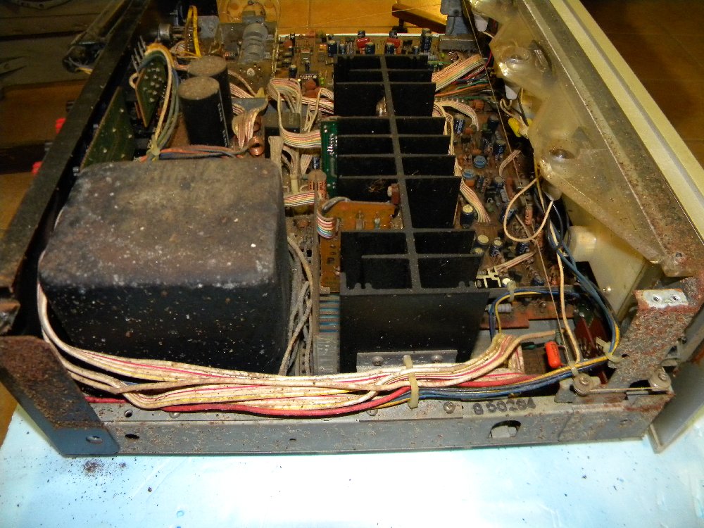

Regarding general condition, it is a little dusty, but I've seen far worse.
That can be cleaned up:
I'm not seeing a cracked diode, just the parting lines from the mold.
