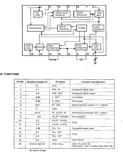

Hello guys. I am from Brazil and I maintain some receivers but the Pionner SX1980 is not very common equipment here. I searched for a lot of research before creating this topic.
Started with the 2SK34 with problems what solved with the tip of substitution (markthefixer) and some more repairs in the source and everything is with the tensions in order.
However, I do not have AM tuning (this does not interest me), but the FM has tuning but does not indicate anything and the three light fine tuning, stereo, lock function lights do not work, but I have FM tuning and it does not change with FM in mono or stereo and Fm Muting.

2 - Replaces the PA3001 IC for a HA11225 and I immediately had the Signal pointer working perfectly fine, but I still remain without the indication of stereo, fine tune and Quartz.

Reading some comments in audiokarma, I detected that I could make use of some ICs, but without success. HA1137w, HA11225. But I detected that the CA3089E ( Replace to PA3001A ) could be a compatible item and so it was, it worked but without the indication of STEREO.
A brief retouch on the VR3 trimpot and Light Pilot Stereo Turn on!

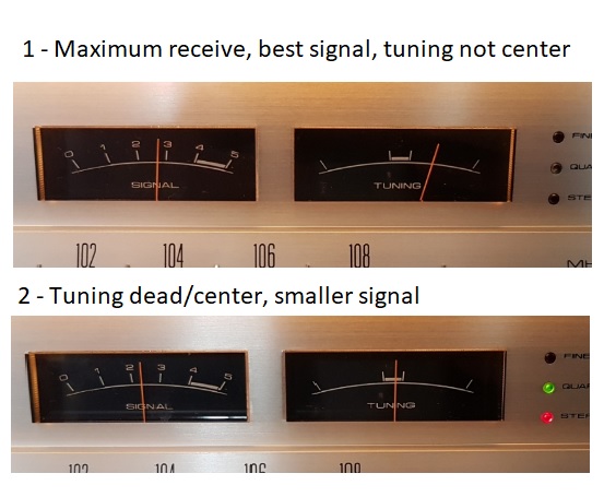

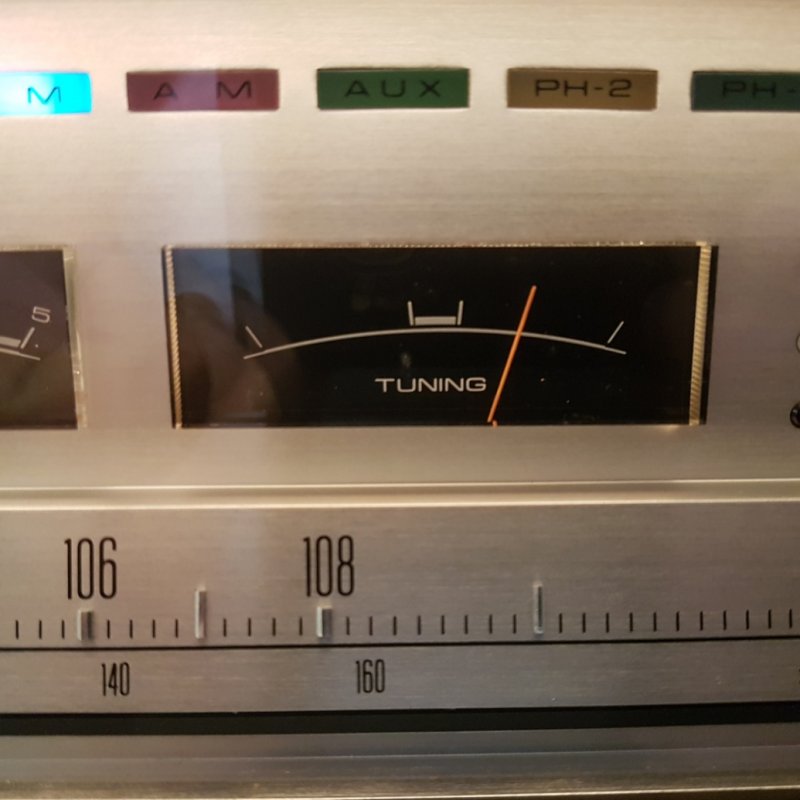

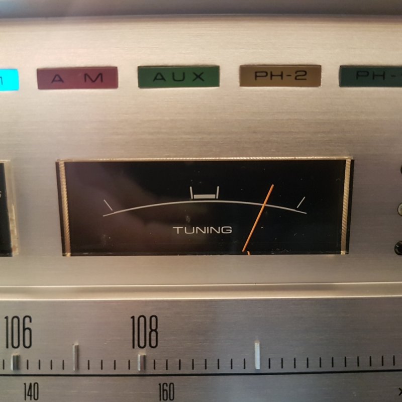

But I noticed a slight imbalance: When touching the touch, (fine tune on) the Tunning pointer drops far to the right, and when you release the touch, center the tuning in the middle and turn on the stereo.
I could not understand the logic of this happening. Is it the fault of the integrated circuit I put in?
Please check Pictures :
Tuning Right on touch :
https://uploaddeimagens.com.br/imagens/49089b6f-de3f-424b-bba6-c6247fdf9a65-jpg
Tuning Center release touch :
https://uploaddeimagens.com.br/imagens/f28c53bd-2401-4a31-8fee-f0a951d1c33f-jpg

Today the receiver has great tuning, I have a new IC PA3001, LEDs (functions) Tunning, Quartz Lock and stereo are ok.
I had an initial problem with little tuning I changed all the electrolytic capacitors, cleaned the variable capacitor, lubricated the middle of the shaft, replaced HA1201, checked the grounding of the block and had an excellent tuning capacity, better than Marantz 4400, Marantz 2110, Sansui 9001 for example. I had the opportunity to see another SX1980 working and I noticed that this one I'm working on, still has a small problem, but the tuning of this one is better than the old SX still all original.
The best signal amplitude is seen by the signal hand, but the tuning hand is not "dead center".
I made a video that can be seen below, and the photos can help to understand the relationship of the best signal and the display of the tuning (1) and the signal in the dead center and center and the smallest sign with less tuning capacity (2) .
The problem is not in the indication of the tuning pointer, but the whole reception circuit is showing the best signal reference on the right. I tried some adjustment on T1, TCA, TCR1, TCR2, TCR3, TC0, confirmed Q1, q2, q12 and q13 are functional, tested off the board, with a resistor between 12 to 25 terminal tuner assembly. I didn't do the test in q3 (Could it be the front end mixer?)

The signal is set at 4.8 (80%) + -99dB.
Please check picture and video

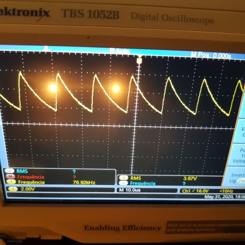

My initial suspcion is that the 76KHz oscillator may be off. With a 50MHz oscilloscope, that signal should be measureable, The waveform will have to be carefully analyzed to determine its true wavelength, then calculate the frequency. Adjustment is typically made via VR1 for the PA1001-A IC.

I did the test that you suggested, as shown in figure IC1001 the reading result on pin 15 I managed to reach the minimum of VR3 at 64.5khz and the maximum 84khz ( autorange config the Tektronix TBS1052). Test with another PA3001 or HA1137, with no changes. In any setting in VR1 or VR3 there is no change in the signal pointer. Was this test what was this of recommended?
I did another test, when using the HA1137 ( but I can't get the STEREO light ) I made a comparison with no radio, see the result of the pointer in HA1137 and PA3001. When moving VR1, there is no change in the frequency read.
76khz
1001 :
Pa3001
HA1137 :
