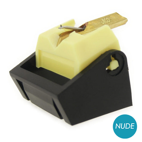

I will be restoring a Heybrook TT2 turntable with a Linn Basik LVX tonearm
Please help rate these cartridges from best to worst
1 - Shure M75E with stylus
2 - Shure M95ED no stylus
3 - Stanton 981 HZS with stylus
4 - Audio Technica AT8008 with stylus
5 - Audio Technica AT140 ML no stylus
6 - Linn K5 no stylus
I would ask for some help deciding which to start with.

That would be the easiest one of the "no stylus" group (provided it actually is an AT140ML and not an AT-ML140(/OCC)), if you'd like to equip it with a new, original needle, as you could simply equip it with a new VMN40ML. And the Linn could be upgraded with AT-VM95 family needles, with which it would also look fairly good. Whereas for the two Shures you'd rather have to go for 3rd party replacements - which are available up to very high quality level (Jico SAS), though.
Ranking is somewhat difficult, however, as that would depend on which needles one would put on the ones, that currently don't have one. If all six were equipped with their original, stock needles, I'd see 5 and 3 at the top, 4, 2 and 1 in between and 6 at the bottom - from a technical point of view. But in practice it's of course also a matter of taste and system synergy, so you might as well for example prefer one of the two Shures with a Jico nude elliptical to the Linn with an AT-VMN95SH.
Personally I'd probably simply start with the Stanton, unless I'd have a good reason to suspect, that its needle is already rather worn.

For the money I suggest that you replace the whole cartridge with a AT-VM95. Get only the nude type stylus. There are 3 different ones with the nude stylus.
The reason for the whole cartridge is because it doesn't cost much more than just the stylus.
Yes, I agree, Stanton if it has original D98S stylus (Shibata, not elliptical or 78rpm) in good condition, would be the best of them.
However Audio Technica AT-VM95ML for $169 will outperform it because of better tracing.
I have 881S and use it with 78rpm stylus, original Stereohedron is gone more than 20 years ago.
So maybe consider to buy new cartridge not try to restore used. New ML tip will not cost less than complete cartridge.

The AT are the most supportable just because the company is still around and making things, but the Stanton is probably the best of the group. If the stylus wears out though, you're a bit SOL.
The Linn Basik tonearm will have the Stanton installed, so that will be my first to try.

While I am a Stanton/Pickering fanatic, those with good original styli when worn are, get them re-tipped. I have yet to find generic styli I am 100% happy with in all aspects. A-T oldies which can accept current genuine styli are excellent potential choices. For Shure better models, Jico is excellent if the options you need, and can afford are available. Food for thought.
