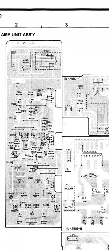

I've been looking at the schematics for two hours. I understand the system flow. I sort of understand the wiring. The actual electrical components are like Latin to me.
I've attached a picture...
The headphones are in the upper right corner, I think. That's where they are in the wiring and schematic diagrams anyway.

No, that just distracts. Just post that schematic section of your PMA2000R - so one can see, what's going on (*). What that section needs to show, basically is just the last bit of the power amp section and the path to the speaker-outs and headphone-out.
Well and generally speaking, what Andrew has already tried to explain to you, is that in most integrated amps and stereo receivers the headphone-out is simply driven by the power-amp section - either just via series resistors, in which case the impedance of the headphone itself becomes the second part of the voltage divider, that it forms together with the series resistors (typically one per channel), or in some cases (e.g. Kenwood DA-9010) also via a voltage divider (in case of that Kenwood the first part of that is formed by a 330 Ohm and a 150 Ohm in series, and the second part is formed by another 150 Ohm resistor), so that the impedance of the headphone merely alters the voltage division to a certain degree.
Example: For simplicity of calculation in your case, let's assume a series resistor solution wth 500 Ohm, then with your 2000-Ohm-Sennheiser the power-amp output voltage would "see" a total load of 2500 Ohm, so that 1/5 of the voltage would drop at the series resistor and the rest (= 4/5) would drop at the headphone. In case of an amp with ca. 80 W @ 8 ohm, that output voltage would be ca. 25 V(eff.) maximum, so that a 2-kOhm-headphone would still get ca. 20 V(eff.) maximum. See?
Now let's assume a 50-Ohm-heaphone instead - then the total load would be 550 Ohm, so that 10/11 of the output voltage would already drop at the series resistor and 1/11 would remain for the headphone - and that remaining part would be ca. 2.3 V(eff.) of those ca. 25 V(eff.).
So, as one can see, such a series resistor solution has the advantage, that it practically adapts to the requirements of different headphone models, providing a pretty high output voltage to high-impedance models and a much lower output voltage to low-impedance models. However, the disadvantage is, that the output impedance is comparatively high - and of course in case of headphone models with rather variable impedance over frequency the voltage division would also vary accordingly, so that the frequency response could differ quite a bit from the frequency response in combination with a dedicated headphone amp with pretty low output impedance.
