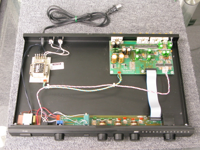

After playing with a few preamp, I reached the conclusion that less is more, op-amp seems better than discrete circuit.
My best preamp is Rotel RC-870BX 4 5534 op-amps, I just got a Soundcraftem P100, and only 2 opamp and is kicking ass, if you see the inside is empty, still very good preamp
