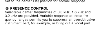

My R-2000 has a Presence Control dial with a switch for selecting center frequencies of 0.8 kHz, 1.6 kHz and 3.2 kHz. According to the user manual, it is meant for suppressing "overobtrusive" (I like that word!) instrument parts or bringing out a vocal part. I'm assuming that in the case of my receiver, the switch only comes into play after I dial left or right of noon/flat. Flat means probably no "filtering" is happening. Is that correct? It's like defeating specific frequencies?
Do any of you have a frequency suppression option like that on your receivers? Do you guys ever use this?

The Presence control is midrange boost or cut, nothing should change with control centered as you mentioned. The center frequency for this +/- is one of the three selectable. Use it excessively to learn what it changes wrt to frequency and amount of boost or cut.
The loudness is variable. More compensation at lower settings (when you turn the compensation ccw.) It lowers volume and boosts bass and treble to compensate for natural hear sensitivity.
