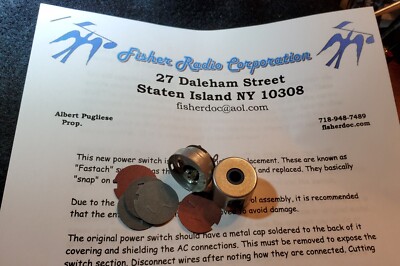

Being a simpleton I’ll ask: why not just replace the switch?
Hi. Yes, replacing the switch is an option but is very difficult for many reasons including the way the switch is attached to the pot along with the very distinct possibility of damaging the switch during the process (I know this from first hand experience having broken a switch while trying to remove it). Also to consider is the maze of wires involved. It's just easier in my view to remove the entire switch/pot combination and then insert it as a whole into the chassis that is being worked on.
Time to hit up barter town for a used spare whole pot ! I thought I had one lying around. I looked but now I think I gave it away a few years ago. I will ask the guy who got the freebies
A much better, detailed, and accurate description of what I called "a bit fussy."
In addition, even if you get the switch off of the "old" pot, it is easy to damage the switch when attaching it to the "new" pot.
