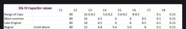

I recapped a pair a couple years ago, here are three screenshots I took that were useful. I assembled the caps from DigiKey IIRC, the first screenshot was from another person, doing 2 pair of speakers (so its doubled). Screenshot 2024-02-05 205839.pngScreenshot_20240204_214403_Chrome.jpg

Hi Sinnerboy, I received my recap kit from ebay, and something is odd. I noticed that my board has an 8.2 cap in the c5 position, and nearly everything I find online shows a 6 or 6.2 in that position. Do you recall whether or not you had two 8.2 caps on each board?
Here's what I had.
C1 - 82uf
C2 - 16uf
C3 - 6.8uf
C4,C5 - 6.3uf
C6 - 8.2uf
C7 - .1 uf
C8 - .15uf
I ended up with those values by researching a lot, mostly on this site. I recall Dahlquist changed the capacitors as the years rolled by, both values could be correct (?)
Yes, values changed over the years. This can be dealt with by being close, OCD folks might go nuts but it is ok. Early units had electrolytics and these could vary, probably by 20%. Just doing both speakers the same helps.
In my research I’ve seen a number of different values. These could be from folks grabbing their own caps, Regnar listed is one set they provided to someone that rebuilt his units, not that they would always be the same. We are throwing hand grenades, not darts to hit the target. Quality parts matched sided to side and within the ranges should be all you need. Mine are that way and folks are amazed at the sound. Especially with high quality tube power. The borrows Marantz 8B really does a great job with them. Older document not showing the 82μF being used a lot these days.
