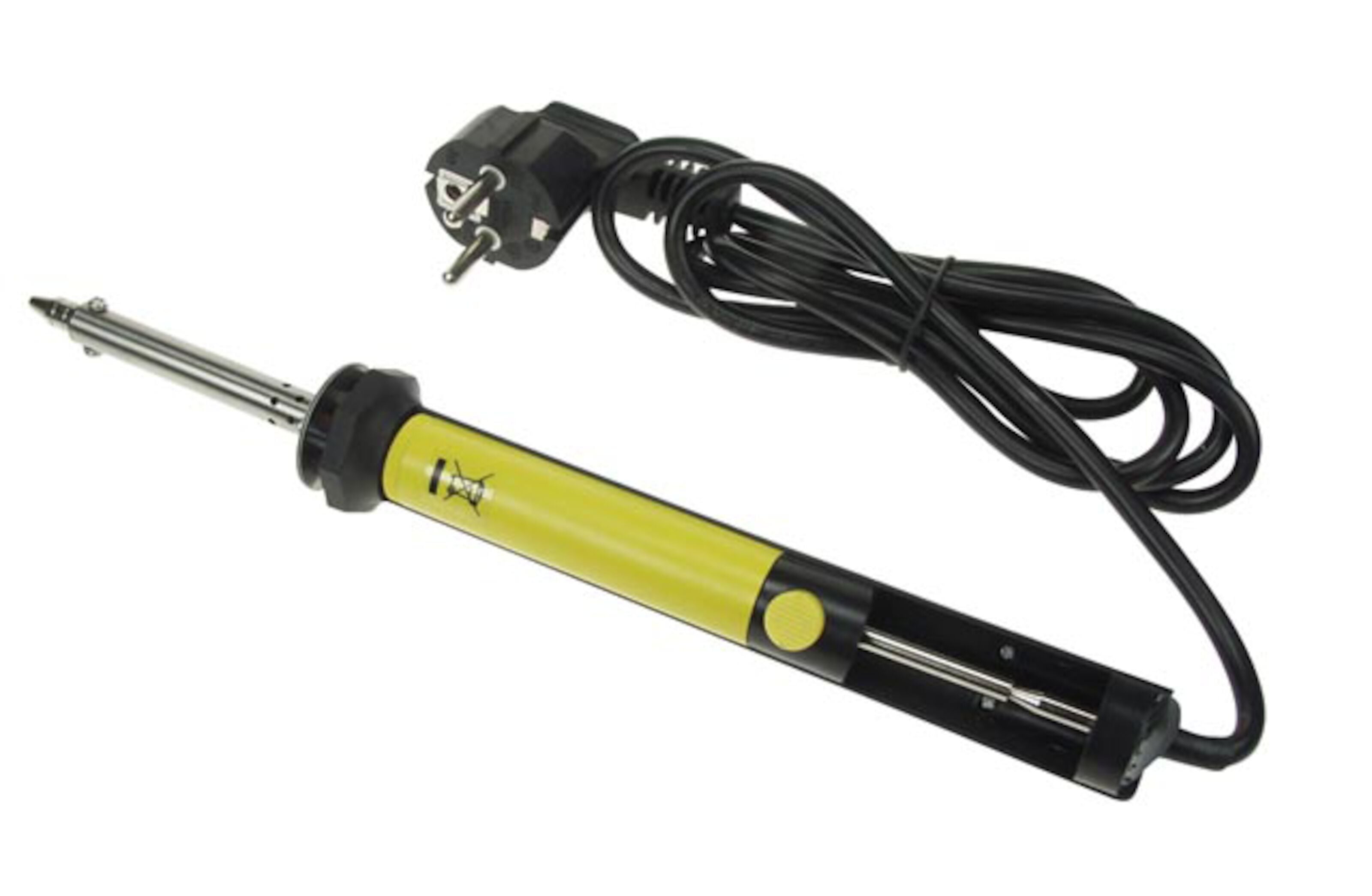

Lastly the thing that makes me consider taking it to a service tech instead of repairing it myself is that in the past I have struggled with un-soldeing parts. I have a big hatred towards solder suckers and even though I have soldered a lot in the past I could easily count the number of times I have been able to de-solder something with a solder sucker on one hand. I have been thinking about buying a inexpensive electric solder sucker like this one. Does any body have any experience with these? https://www.kjell.com/globalassets/...ef=6F748C2C10&format=jpg&w=960&h=960&mode=pad

I have not used that type of solder sucker before but it is a "manual" version of the higher end models.
Two differences, It is a "one shot" not continuous vacuum as the big boys.
And second and more importantly is from what I can see it is not temperature regulated which in my experience is very important,
Heck probably the most important feature of any soldering iron, solder sucker. Too much heat will quickly damage and lift traces.

i bought one, used it a few times. i had to take a file to the shaft as it would not stay engaged.
they are really awkward to use. i went back to the manual sucker and soldering iron before i got a pump.
when they work they are ok.

I bought one of these about a month ago & have used it several times.
It works pretty good but isn't perfect.......no heat control, no on/off switch, just an led that shows it's on, & only two small tips included. Also, the "sucker" tube itself is suspect. The suction is adequate, & you get a couple extra O-rings with it but I've had to clean it & lube it with some wd40 a couple times. It's a step up from using an iron & separate sucker but I don't think I'd trust it on a "delicate" PCB.
