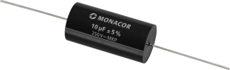

So I did it, the hard way! No half measures here haha. I desoldered the terminal posts and removed the circuit board completely before proceeding with the recap.
The hardest part was removing the old caps from the rock-hard hot glue/adhesive. Once removed I spent some time filing down the remains to an acceptable height.
Followed by cleaning up and removing all
old solder on points. Then wired in the new caps and cleaned the L-pads before reinstalling.
In terms of sound I am very pleased with the results. My right channel speaker has come back to life completely. Vast improvement across the full dynamic range, more thud from the bass, mids and highs are pulled forward considerably and stand out much more than before! If anything the HF is a bit harsh but I presume they will settle in with time.
Would highly recommend this on a pair of 2500s purely due to age alone.
Thanks again to everyone for the help, tips and advise. Images of process attached.

Yes I feel you, making a decision when it comes to components can be endless. In the end I opted for the Monacor caps as they meet the ratings I was looking for, fit the crossover for replacement and are fairly reasonable priced.
I ordered mine through a company called Crinklewood Electronics as based in the UK.
