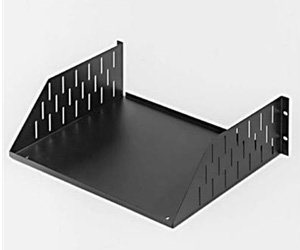

I'm sick of the mismatched rosewood cabinet and found a cheap 19" trolley which has a huge space at an angle.
Looks ideal for a R2R.
Any ideas to convert my akai 650d to securely fit into it ? It's not made to fit in a rack but I would love too. it's 18" wide.
I think best is to make a shelf for it ?
I'm not going to hang it on the side panels :-D
It's unlikely you'll find one of these sized for your deck, but you may find ones for other decks that fit. It would only attach to the back of your case, not the side.

Or, make new sides for it with rack 'ears' attached, and keep the existing cabinet sides for non-rack use. You'll only have to finish the wood nicely on the front/top edge of the new side panels.
You could use a shelf beneath, with a support to keep it to the front, and cradle the back with a u-shaped bracket so that it doesn't tip back.

Easiest would be the shelf and fabricate a support for the back.
the 650 is enormous and heavy so it has to be sturdy. I'm sure I can diy it.

Finally got on the comp so some pics to help with the idea:
This is the rack where i want the r2r on the top angled part.
I measured and it fits very snugly.
I'm thinking this as a bottom support.
And this 11cm deep vesa mount for the rear (i will mount a sturdy hardwood plank on it)
Doing this i can simply lay the deck inside and the reels will poke out a few cm, and i can easily angle the deck for cleaning etc ... :D
