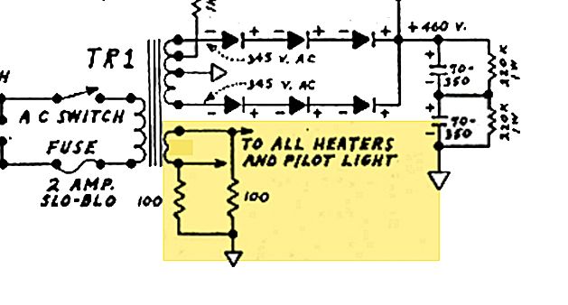

That's probably what's happening. One leg of the AC heater line (6.3VAC) may be grounded. So, the power line polarity is critical. You should probably go to a three-cord outlet line with a green line grounded to the chassis. Something like this:
If one side of the heater line is grounded, you might consider changing it to two twisted pairs and pulling that one line off the ground. Use resistors to create an artificial center tap. It will run quieter.

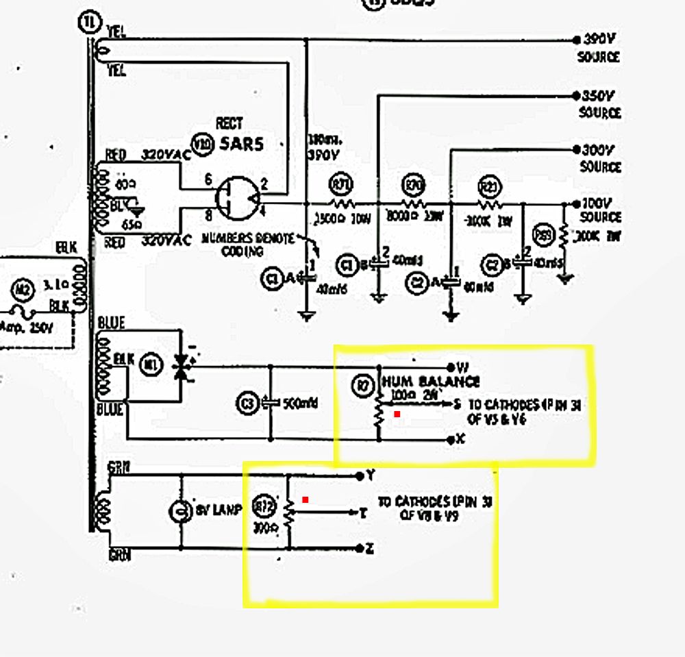

With any of these amps in question, a schematic (if possible) should be referred to. I hope that this is your amp. Please double-check to be sure.
Click on image to enlarge.
I found this on the Net: Your amp seems to have HUM pots on two of the power transformer's lines.
Try adjusting these to reduce the AC hum that you are getting. Eventually, you may consider a three-prong line for safety's sake.

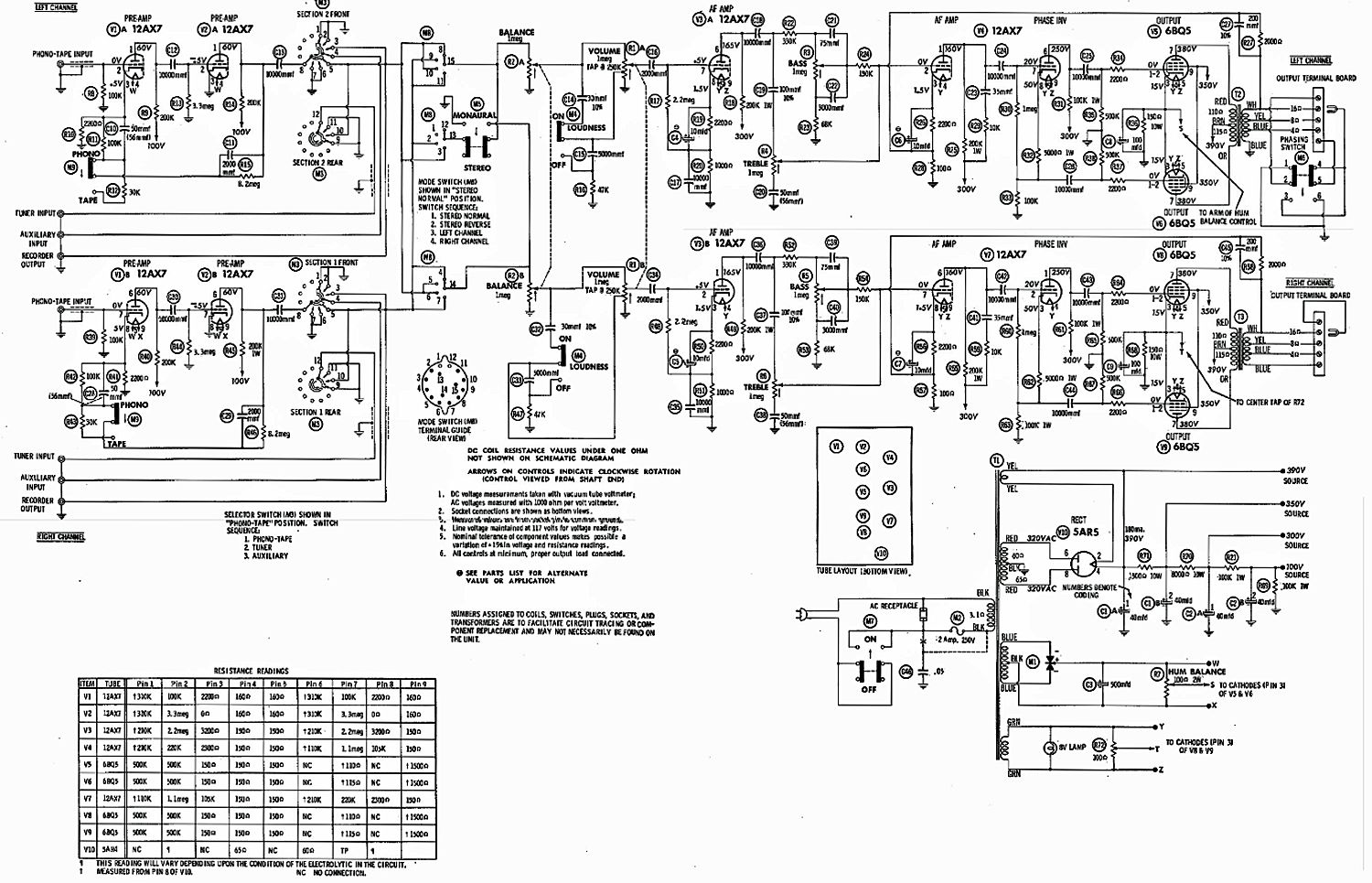

So I don’t think that schematic is for my amp unfortunately and I can’t seem to find one.
My amp has one hum balance knob in the back. I didn’t want to touch it with a screw driver though since it has 6.3VAC on it.

Radio Shack Stereo 40A is covered in Sams 519-12 - I believe that's the schematic posted above.
