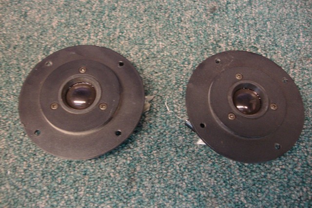

May I please get your opinions for tweeters, for restoring some Realistic Optimus 5's? I bought a hacked-up set with great cabinets for $40. But one woofer had been replaced with a home theater woofer (!) and the other one is the original 3007Aa woofer but has been re-coned. I've purchased a replacement 3007Aa and will eventually replace the re-coned one. All midrange tweeters are there and intact, but one tweeter was replaced with a 4-ohm computer speaker tweeter and the other is an 8-ohm Realistic tweeter with a mystery part number 0725Ab. I *think* this might be from an Optimus 5b/Nova 8b, but not sure--I thought those were 0725Ac part numbers.

Pics if you're curious
Mystery tweeter (from a 5b/8b?)

These are a nice replacement for the paper cone tweeter.
I have them in a set of Nova 8Bs that I've had for 25+ years
40-1276B
Thanks, I looked that up and it looks like those are 8 ohm? I think I'll need to stick with 4 ohm tweeters to be able to use the original crossover design for the Optimus 5. Maybe there's a 4 ohm version though.
Yep. My goof. Once I got Nova 8B in my head, all bets were off :)
But since I already pushed a silk dome on you, how about one in 4 Ohm?
