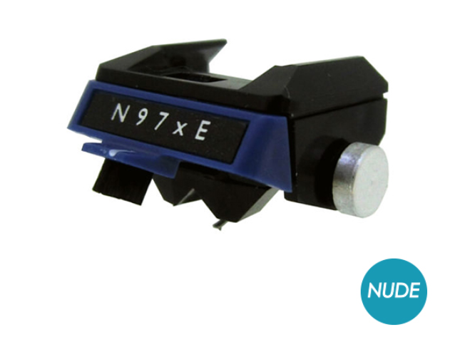

you are right to feel uneasy about those cheap needles. The V15 RS is a very nice sounding cartridge and deserves a better stylus than the Pfanstiehl.
This is a much better option....
if you have a tight budget, these will work...
