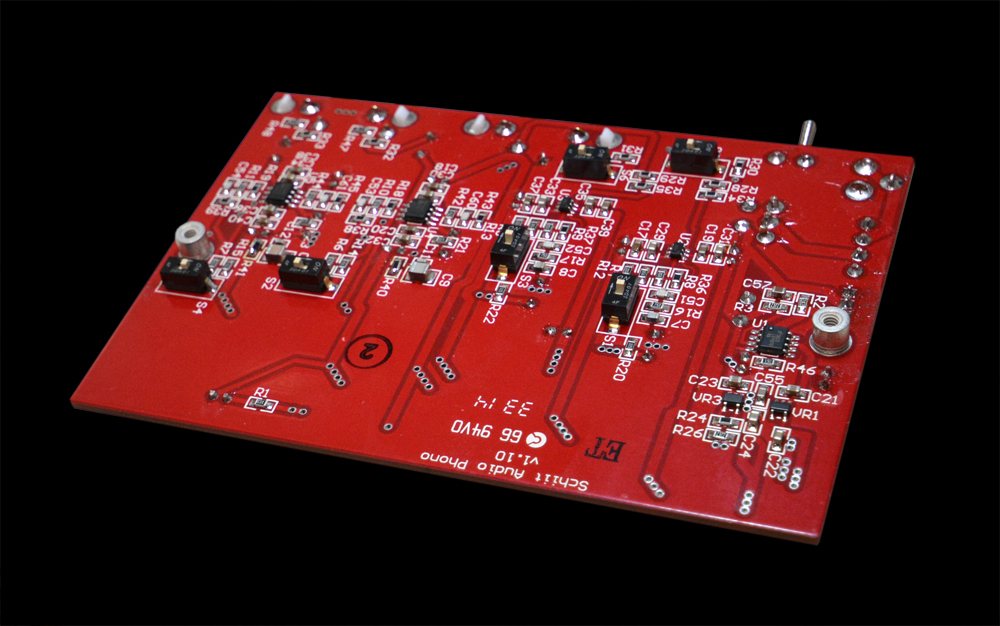

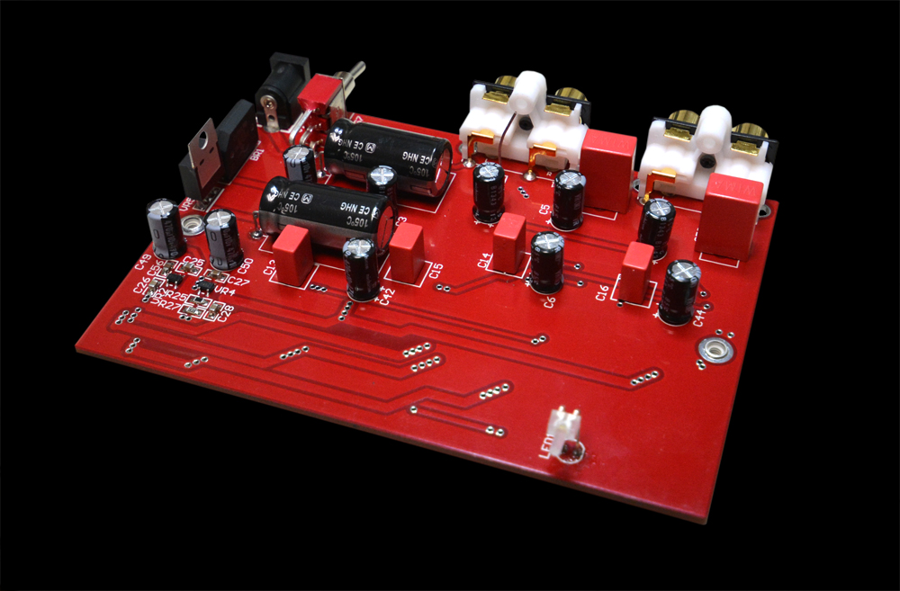

I have a weird question here, I'm not super well-versed in electronics, but I'm pretty good with soldering and replacing PCB-mounted components.
I have a Schiit Mani phono preamp that sounds VERY good for the price. The one drawback of this preamp is that it seems to have a pink-noise sounding fuzz when you crank the amp up. It's in the background and isn't super bad when the music is playing, but in quiet passages, you can clearly hear the fuzziness in the background.
I'm wondering if going in and replacing some of the components inside the preamp would make any difference with this? I'm not sure exactly what the noise is.
http://www.schiit.com/public/upload/general/mani bottom 1000.jpg
http://www.schiit.com/public/upload/general/mani top 1000.jpg
Different caps not likely gonna reduce noise unless one or more are defective. IC's, resistors, transistors could be another story.
+1. I see op-amps on the pcb, but they are surface mount, so no rolling op-amps. If the noise bothers you that much, then get something else.

Some phono preamp's have hiss at high gain, there's just no getting around it.
Hum is another matter- proximity to power lines, any sources of RFI. I had a preamp that would hum unless it was on it's side. Looked ridiculous but it worked that way.
I had a few preamp's that were hissy...I tried modifying them....power supplies, caps, opamps, all a waste of time and money.
I finally decided to pony up and buy a used AR PH3, which was cheaper than all the money I poured into my inexpensive hissy preamp's.
This is absolutely correct. In fact, all phono preamps hiss to some extent - and getting the hiss as low as possible has been a challenge for electronic engineers since electronics was invented. However, I wouldn't expect the hiss to be a problem with a modern mm phonostage. Maybe the noise is power supply related and due to the use of a switch mode power supply. The Mani takes 16VAC in and looking at a picture of the circuit board on Shiit's website I don't see the sort of components I would expect to see for a conventional power supply, so I suspect they're using a switching regulator. Maybe that's the problem :dunno: If so, just swapping a few caps won't do any good.
