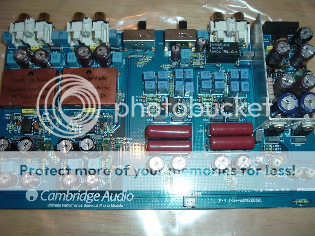

I read many posts on vinylengine.com about modding a 640P Phono Preamp that's already a good performer right out of the box. Not being a tech I decided to take the safe approach and just recap it to see if any improvement could be had for a modest investment.
I picked up a nice used unit from a fellow AK'er and this is how it went.
Lead free solder warning, this is not easy to work with, the old lead based solder they used was MUCH easier. It took me up to ten minutes to remove a capacitor because this stuff is like steel, it doesn't melt easily and doesn't run like lead solder.
I used this method to remove the capacitors:
I cut the stubby ends of the legs on the solder side of the board as close as I could to the solder joint. I then used solder wick to remove as much solder as I could, but the holes are so small and the legs are a tight fit, so even the most minuscule film of solder will hold them in. I would then reheat them to gently pull the leg out. On a lot of holes I would have to ream them out so the new legs could fit, a thin film of solder would slightly reduce the hole size making it too tight for the new legs of the new capacitors.
I check each solder joint I make with a magnifier and a resistance meter just to make sure.
Here is the untouched board, notice the brown glue in places, very untidy.
There are 30 electrolytic capacitors all up but I only would replace 24 as I don't own a low output MC cart, I have the 6 replacements on hand, but I wanted to get the MM part done first.

I was going to use Elna Silmic II caps for the most of the main board, but they were rediculously larger than the originals and the legs much thicker. Rather than do a hack job I decided to throttle back and use Panasonic FC's.
Here's a pic with about half of them done:
The caps with the black dots are the originals and the ones without are the replacements, the replacements under the MM stage op amps are much bigger than the originals to their left. All the replacements were bigger, bigger is better right?
Also notice there are two caps missing near the switches at the top. They arrived tonight.
Here's the final pic with them all replaced except the MC phono stage ones, as I explained they will be done later after some serious testing of the MM stage.
Total cost for caps was less than $30.00 including shipping from Digikey, if all ordered at once.
