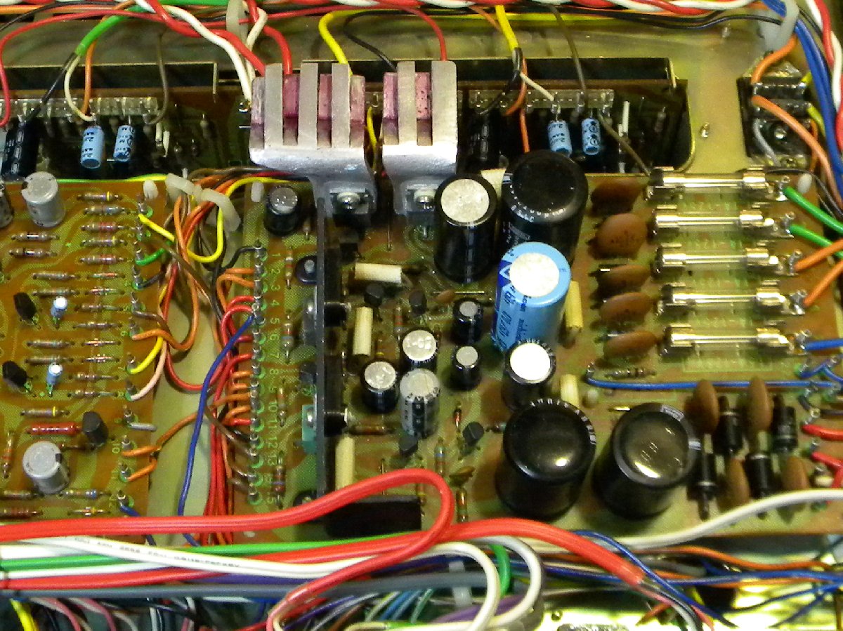

Given that both these TO-220s ran very warm, I'm thinking this is what you may have had in mind:
They are lower (higher?) than the tallest E-cap on that board, and now have mica and insulating washer so the sinks aren't live.

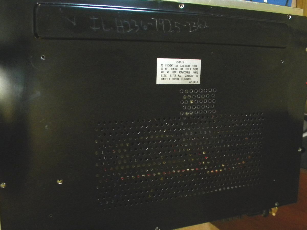

The dual TO-220 array is also shrouded by the bottom cover, preventing any convection air from passing their heat sink. Measured heat on the stock heat sink was acceptable (I could hold my finger on it indefinitely) but there was concern over the shrouding. Extending the factory vent hole pattern to allow air under the area may not have been necessary, and I hope it doesn't negatively affect the air flow there.
