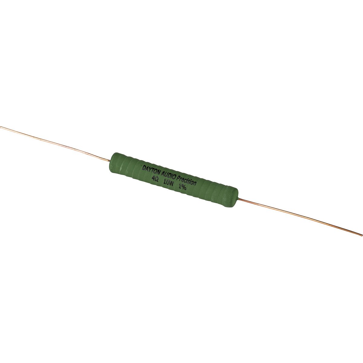

Not absolutely necessary but as long as you're in there, replace the 4 ohm resistor with one of these.
