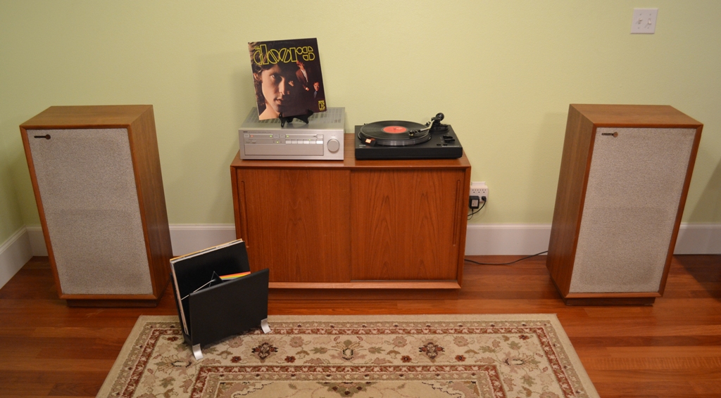

Look what followed me home tonight:
Two pair of classic speakers in one night. Quite the haul. I bought the early Highboys from the original owner. The have beautiful teak cabinets and are in very clean, 100% original condition. The KLH Model TWENTY-THREEs aren't quite as pristine, but still pretty good considering the age. One of the woofers isn't working. I'll start looking into that this weekend.
I had to also include my 1967 Benjamin Miracord 50H (bought from the original owner last summer) in the photo with it's beautiful teak case. Only the Yamaha A-1000 integrated amp isn't period appropriate.
More to come...
