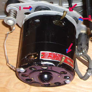

I have begun to breath new life into my father's old turntable. So far I have simply cleaned up the outsides and replaced the idler wheels. Whether I have it set at 33 1/3 or 45, it goes at a reduced speed until I move the platter at a higher speed and then it comes up to the correct speed that is maintained (until it is turned off). I am assuming that I will need to make sure the spindle is properly lubricated after ~58 years, not to mention the motor. My motor does not have the two lubricating input funnels like seen on "Rek O Kut Tips" ( https://3.bp.blogspot.com/-ffahCVs2qnc/T-avHJFSfeI/AAAAAAAACL0/XKKOYlGOZFo/s320/ROKmotor-2.jpg ). When I replace the seven motor grommets, I may as well try to clean and lube the motor. Will this be obvious when I remove the motor or is there anything I should know ahead of time?

Thanks for the link. I assumed that since the motor didn't have the same oil input funnels, it was a different motor. Looks like I need to check if there's a label ID on the motor like in my link. Time for a flash lite...
There are no markings or labels on the motor other than "patent pending". So I have a different motor, but won't know more until I extract it from it's mounting. I'm hoping a minimal amount of intervention is required, such as some lubrication on both ends of the motors axis, otherwise I'll be tinkering more than I want to...
Is the motor square or cylindrical? I use to have an L-34 with the early square motor - aka the "Borg Death Cube" - and successfully opened and re-oiled it. You have to drill out the rivets at the end to get to the bearings. If you want to replace the ball bearing, PM me your address and I'll send you the correct one.
The cylindrical-style motor should have oil spouts, making the job much simpler.
Alas, mine is not square but cylindrical and yet no oil funnels. Since it’s still a mystery motor, I’ll free it from its moorings soon and maybe take a picture to share. Thanks for the offer...
It looks like the one on the right. It doesn’t have any identifiable markings on the side or bottom, so hopefully there’s something on the top...

I redid an L-34 and the motor didn't have the oiling tubes either. Draw a line on both halves where they meet. Unscrew the motor and gently pry it apart. Clean the interior with isopropyl alcohol (min 91%), clean the top and bottom of the spindle and then relube with a light oil. Put it back together and match up the lines,screw it back together, and hand twist it to make sure it spins freely. If it doesn't spin freely, take it apart and put it back together again.
