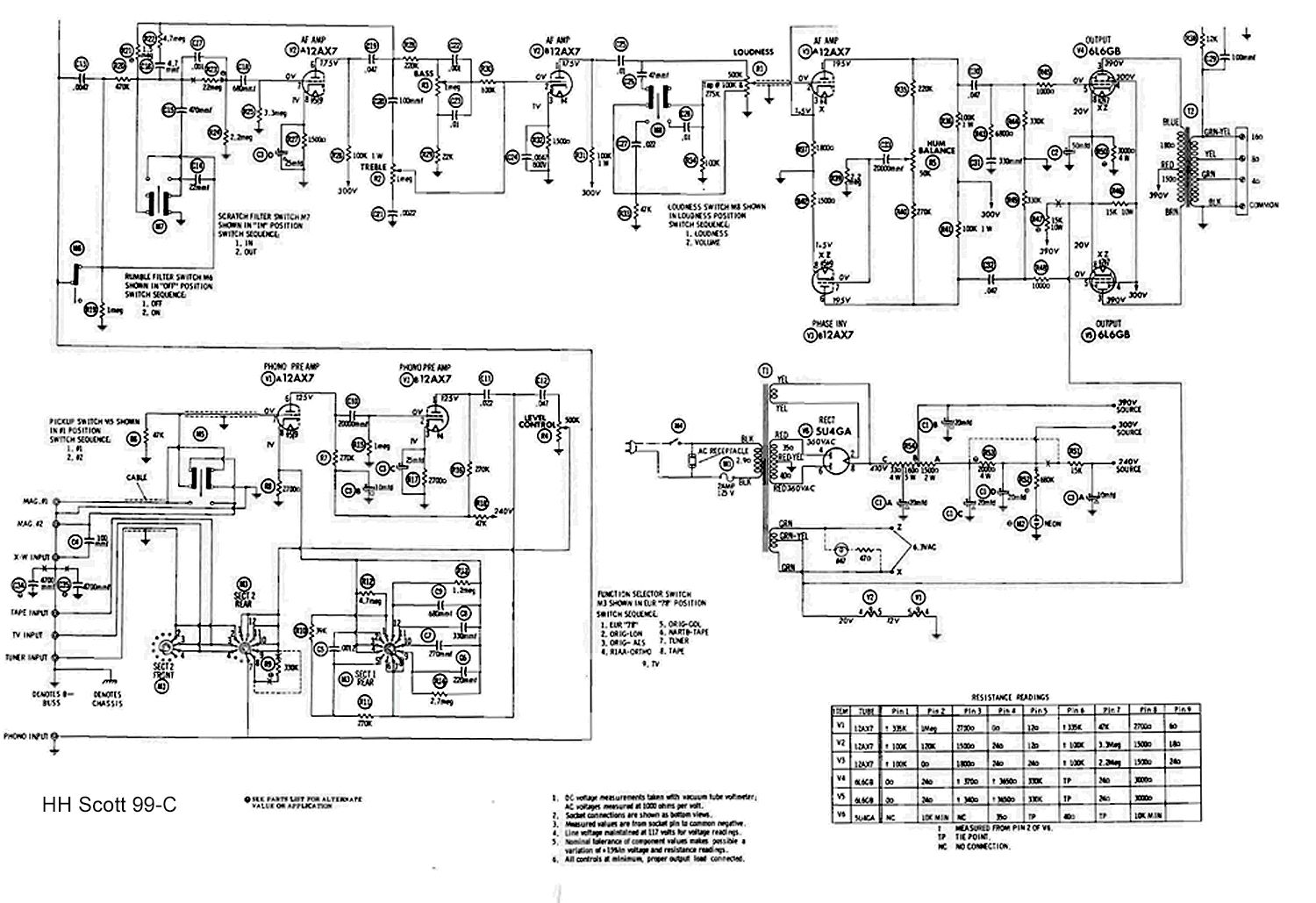

I had my 99c gone over , but there is inconsistency with the bass adjustment, and intermittent severe clipping depending on wich of the 5 phono gains I use. RIAA seems to be the worst with my Hard Bop 33 1/3 lps. It was suggested i replace the capacitors for the phono compensators, which is withn my ability. I have the manual in front of me. Our friend Chat GPT provided the following: AK wont let me attach the schematic, says too large. Can someone tell me if these are the correct caps and values? Also the best site to purchase from? Thank you .

Schematic. The cleanest one I could find. Click on the image to enlarge it.
those values are all pretty common. As far as sites to go to, there are plenty. I would at least go with some sort of film cap. If your budget allows, you can go more exotic film and foils. You may also want to measure the value of the resistors in the RIAA and make sure they are pretty close to spec. Any deviation will result in a shift in the time constants for the RIAA eq.
yeah the resistors will skew this considerably, and may even be the bigger problem. Carbon comp are pretty poor for stability. I'd go metal film or carbon film for replacements, both are much more stable than the originals.
