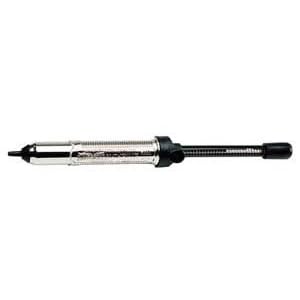

Dip chip puller? I have not used one of those in over 20 years. I used one once and that was the end of that nonsense. I have not used one since. I even bought a DIP soldering tool that heats all the pins at once. All of it was a waste of time and money.
Once I suck the solder out of the hole with a Soldapullt(tm) then break the remaining bond between the lead and the via with a small probe, the chip falls out. On stubborn chips/boards I will cut the leads off flush he body of the chip and then clean up with a Soldapullt.
An 8 pin DIP should be a piece of cake to remove.

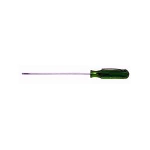

Ok fine.. the C33 op-amps are 8-pin socketed IIRC. What is the "best practice" way to remove them? IOW what is your procedure? anyone? I'm not going to pry and hack at any of these components. Hope y'all understand.
Preferably.. there's a plastic puller available that would grab the op-amp at both ends and rock it end-to-end until it lifts straight away. I pulled many inline ICs when I was a lad, and they came out one side, while the other pins were still engaged.. and all kinds of chop-chop variations. :nono:
Are there any ESD issues?

What I have found works very well for socketed ICs is an Xcelite R3324. It is what I have used for years. While a puller sounds like a good idea, I have found that no puller really pulls the IC out straight. The little Xcelite even gets underneath those chips that have zero clearance between the body of the IC and the socket. It is that clearance issue that causes IC pullers to be useless. To use the IC puller, the IC has to be lifted up using a small screwdriver then the puller placed under the body of the chip. By the time the puller is placed into position, the screwdriver would have the chip pulled out.
Read the thread listed below as well. I just happened to pick a site at random.
http://www.vintage-computer.com/vcforum/showthread.php?19186-IC-chip-puller
I agree 100%. I replaced several ICs in my c34V and used a small screwdriver. It just needs to be short enough to get into tight places.
