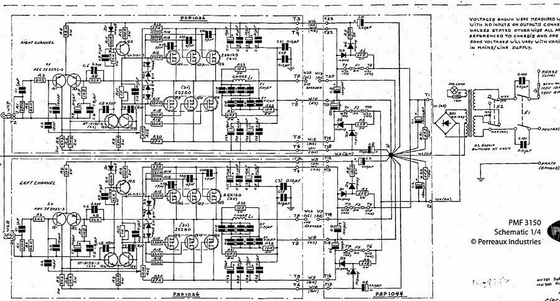

Looking under the hood and WOW! This thing was built really well. Neat layout, and I super duper appreciate how everything coming onto the PS board was screw terminals. And color coded!! Those kiwis sure are nice. Big a$$ transformer, 2x 18,000uf filter caps underneath the PS board (board screwed into the cap terminals).
Next up, diagnostics. Immediately see that rail voltages are off. Ok so what exactly should they be? Perreaux was kind enough to give me a factory schematic, now living in the AK database. But it doesn’t show voltages. Not any…
Ok we can estimate but let’s check and confirm. Starting wit the transformer. Primary good. Mains voltage selector good. Secondary 142V before rectifier. 137V after rectifier.
Wait, what?
Let’s take a closer look at that rectifier, shall we. Is it perhaps not recitifiering as it should? Well let’s consult the AC coupled readings for each rail and see!
Nah, those look fine. Right?

Should be higher than 142 after the bridged rectifier. I calc it out at using 142vac. A bridge rectified dc voltage of around 200vdc. Or in your case. A 100vdc-0-100vdc as your transformer secondary is center tapped.
If not, I'd be looking at the BR and/or the main filter caps.

Yes I’m 99% sure the rectifier is bad.142 AC directly across the transformer secondaries, detached from the rectifier. 137 DC across the rectifier outputs after reattaching the secondaries.
The scope shots above are the positive and negative rails, AC coupled. Taken directly off the rectifier. To my untrained (but learning) eyes that looks like a ton of ripple. And also a different amplitude on each rail. All of which points to a bad rectifier, no?
This is all before the rail fuses in the power supply board. But I will definitely take your advice and double check them!

Try to find the chart that has those nominal voltage read points (T-points) on the schematic (click on the schematic to enlarge it).
I would do this before willy-nilly changing parts.
