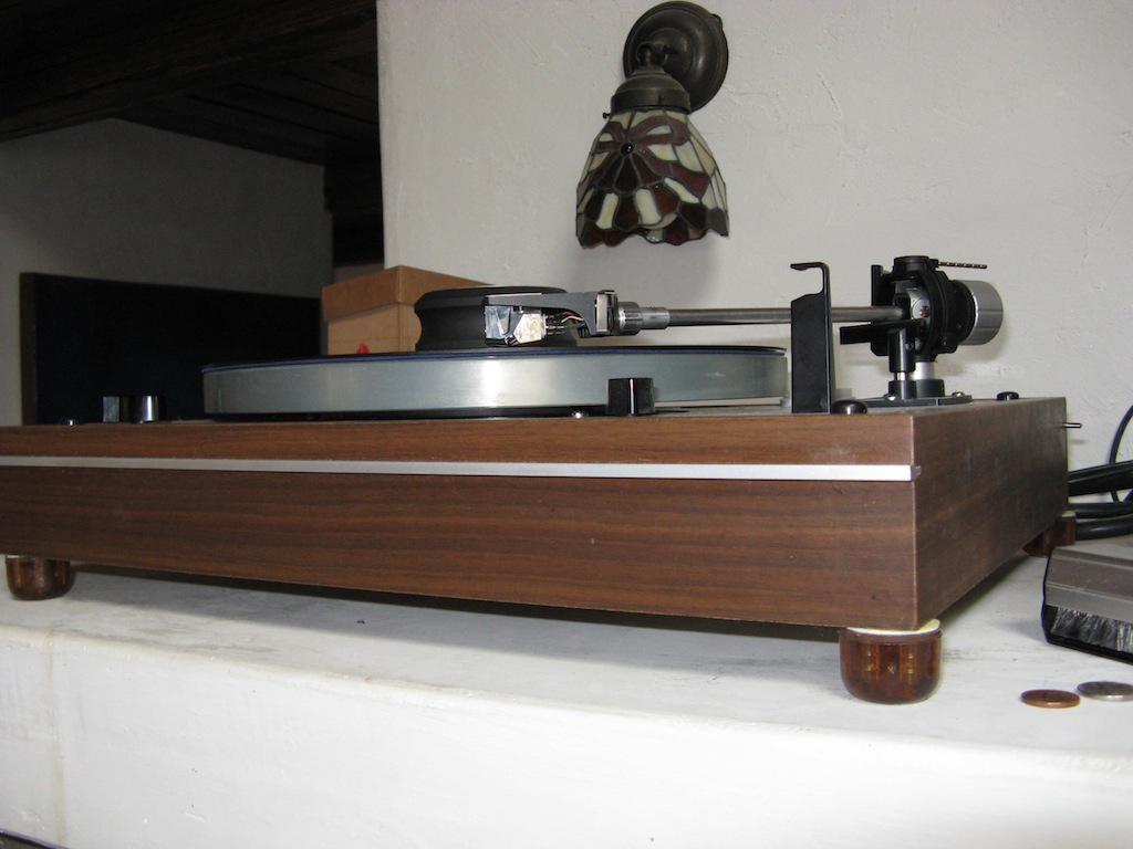

Here's a few pics.
You'll notice I have the arm quite low. Even with the 2mm spacer on the headshell, the arm is still maybe 1mm low at the headshell end.
Seems to be only the TP 16 arm that has this issue.
I'm happy with the sound with this set up, so I haven't bothered to adjust it further.
Lee
I have a problem: I wish I could set my TA that slow!
My TP 11 TA (TD165) does not slide lower that it was and can only be moved up, not down, which I'd need in order to level it.
Can it be blocked or something?

But the problem is now the lever that is used to slowly lower the stylus on the record is always too high, even at its lowermost position, so no matter how low I slide the TA in the collar, there will always be the lever in the way, avoiding the TA to be leveled...
The stylus won't reach the record surface if I lower the TA so that it'd be leveled...

I had to be satisfied with the TA dipping slightly toward the headshell...
But I'd like to understand why I can't level it...
I also think it affects the weight on the stylus...

You probably need to install some spacers to get the stylus mounted far enough below the center line of the arm. Thorens supplied a variety of plastic spacer for just this purpose. The original kit consisted of 1x .5mm, 2x 1mm and 1x 2mm spacers IIRC.

After years I understood what was my problem back then: I had a very thin felt mat. So the record's surface was a few mm lower than normal. No wonder the tonearm was dipping towards the record! Now I have a 5 mm acrylic mat and I've been able to set the VTA, with no problems from the armrest also (actually I set the tonearm height so that it is horizontal when playing 180 g records). Of course I used (self made) headshell spacers to put the stylus tip where it is intended to be (hope the measurings are right - I don't have the gauge).
