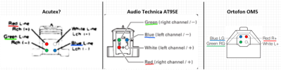

Does anyone know why 2 new cartridges will only produce sound on one channel. First cart from Audio Technica and second from Ortofon. Got TT used with Accutex cart, this works both channels, proving all connections to amplifier are fine. Lastly tried to crimp leads to see if there might be a problem, but problem still persists.
Dual CS-508, original cart - 80-90s era Accutex 207 (Accutex imported / manufacturer ?)
Tried Audio Technica VM95E and Ortofon OM5E
Common ground cart vs not common ground?
Could be one of the ground signals between cart and phono pre isn't making it on the two single channel carts.
Have a meter? With the pins are not connected to the cartridge, do you have continuity on all 4 from headshell to rca plug?

Make sure that your wires from the headshell to the cartridge are correct.

Try reversing the wires (red & green on the left and white & blue on the right)- the Rega Exact carts that came on my P3's were reversed like that and didn't work when I put them on the "correct" way.

Did you check the pins' markings on the cartridges? The layout of them is not the same, as one might falsly conclude from post #3 (it shows the Audio Technica layout)...at least not between the Audio Technica and Ortofon; don't know about the Accutex, but going with what you describe, it's likely different as well.
Here's Ortofon's:
The "standard" pin coding's for cartridges are not standard. Always double-check the cart's documentation to see if it has a non-standard pinout, esp. if you have difficulties.

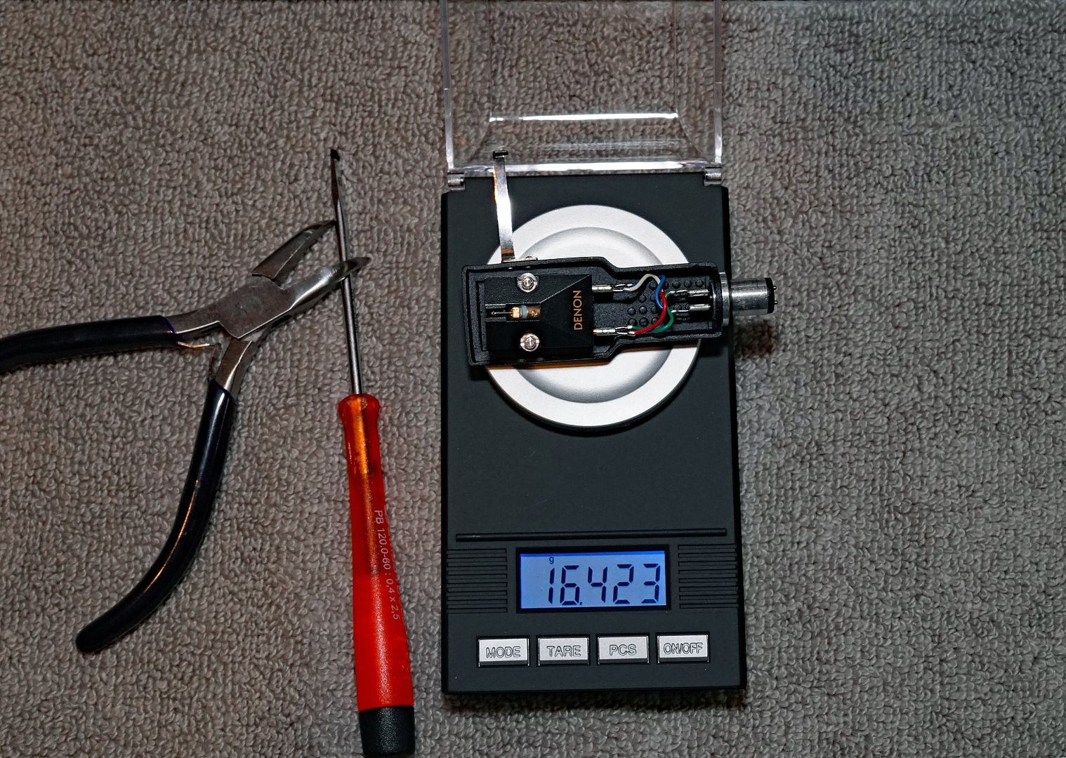

I was attempting to work with the leads in different configurations, but in the process one of the ferrules pulled off the wire. Tried to repair, but that did not go well, so at this point I am at an impasse. There may be head-shells available that replicate the old Dual 1/2 cart conversion, that said their contact points don't appear to be exact to what I have so I am hesitant to get one. Already spent more on the cart upgrade than on the TT itself. In addition to checking the connections for good contact and placement I did get a Dual gauge for alignment on their tone arm, maybe that rules out the azimuth adjustment. In the future whether I replace the head-shell or get another used TT, if needed I will get a meter.

Why don't you post a photo of your headshell and cart for all of us to see instead of guessing.

I looked up the wiring specs for the three carts you mentioned above. ALL three are DIFFERENT.
Make sure that you connected them correctly. Please post a photo of your wiring for each one.

Yes that is what they show, but the first 2 pics are of what I have. Green wire did not survive repair attempt, white wire detached at soldered joint. Last pic from TT retail site shows the actual Dual kit 269-611, sadly it is out stock. I suspect it will unlikely ever be restocked. Getting new leads is a maybe of course I need to learn to de-solder and re-solder. I maybe could do it with the help of a 3rd hand tool.

What I am asking is: when you tried the Audio Technica and Ortofon cartridges to test, and you only got sound from one channel, did you wire it correctly... because all three are wired differently?
Please tell me how you had each of the three cartridges wired when one channel did not work.

I apologize for my late reply, I did follow the color coded wiring correctly. I matched the colors of each wire to the color on each cartridge. Accutex just has left/right - +/-, the instructions from Ortofon list right/left with their color codes. Sent back the Audio Technica, but everything should have matched up with either one. Looking in to ordering new leads to hopefully with care repair the headshell and try again with the Ortofon.
