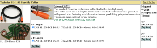

If I understand you correctly, I like these (see below) -
Consider giving Kevin @ KAB a call, tell him 1300 & what you want, he will sort it.
