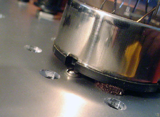

Not a big fan of metal shavings in the chassis, so for me, it's nutz 'n bolts ...
Only complain I ever had is they do tend to stand out from the chassis more than a rivet, and some larger tubes have a tendency to rock. Easy enough to fix with some felt pads ... the little peel 'n stick variety from the local hardware are just the thing.
Whole lot easier than countersinking the screw heads too ...
If you have a cone shaped tool <|- that can mount in your drill press, you could make cone shaped holes to allow the use of flat head screws. Then the screwheads would be flush with the chassis surface.
I see you used the flat pan head screws. I use them too. They look much better than the round heads. Cutting the little round felt pads is a nice idea. Thanks for posting. :thmbsp:
That's a good point, no pun intended. I've done some crude countersinks using just a larger size drill bit. There are specific tools to do that but the drill worked well enough for me.
