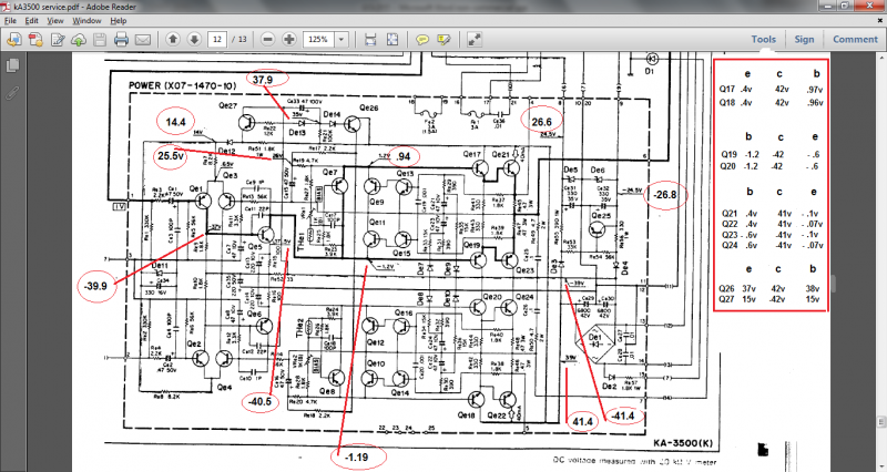

So, after various family commitments, M&M consumption and hair-pulling I haven't had any breakthroughs with this thing other than not blowing it up. Still no mV reading at the bias points. I dissected the 'muting circuit' and tested the values - even subbed the transistors - to no avail. I have taken some measurements and attached the photo in the hope that some eagle-eye spots something.
It seems there is no current flowing through the emitter resistors - the voltage potential is the same at each end of the test points. It's -95mV. So it seems to me that there's either an interruption in the circuit, or for some reason polarity is screwed up somewhere?
The output transistors must be biased at the base by the driver transistors, which should be conducting biased at their bases too.... and, supply voltage must be present at the collector so there is some electricity to let flow. I hope this can help you to trace back the fail.
Can you measure if the drivers are conducting? You should measure voltage across driver's emitter resistor. (Those 330 ohm) Voltage at one driver's base is a bit low. Perhaps that one is not conducting.
Expected voltage at the output's bases to make them to conduct is around 0.6 ~0.7 V
Ok,
Swallowing my pride and posting this so some may learn/be entertained.
Well I did say I was a noob at this solid state gear...
Coming from a background of tubes I am always in the habit of setting the bias trimmer(s) to the lowest setting when installing new tubes, not knowing how much they may pull, and gradually bringing things up. At this lowest setting, some idle current is (from my experience) always still present in the cathode. Moving on, I had my bias trimmers in the KA 3500 at 9 o'clock with zero voltage, assuming there was a fault. Of course eventually in desperation and running out of ideas I decide to start twiddling the trimmers and my eyes nearly pop out of my head when I see the voltage rise. I probably had the frickin' thing fixed a week ago :rolleyes:

Glad you solved it. Transistors need a minimum voltage at the base to start conducting. That is the purpose of the bias adjustment, to keep the transistor always beyond that threshold so it's always conducting and never turns "off".
Regarding the pinout, I've seen the same transistor number with different pinout. I always check them before soldering in place.
