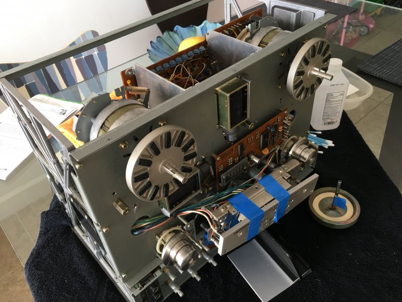

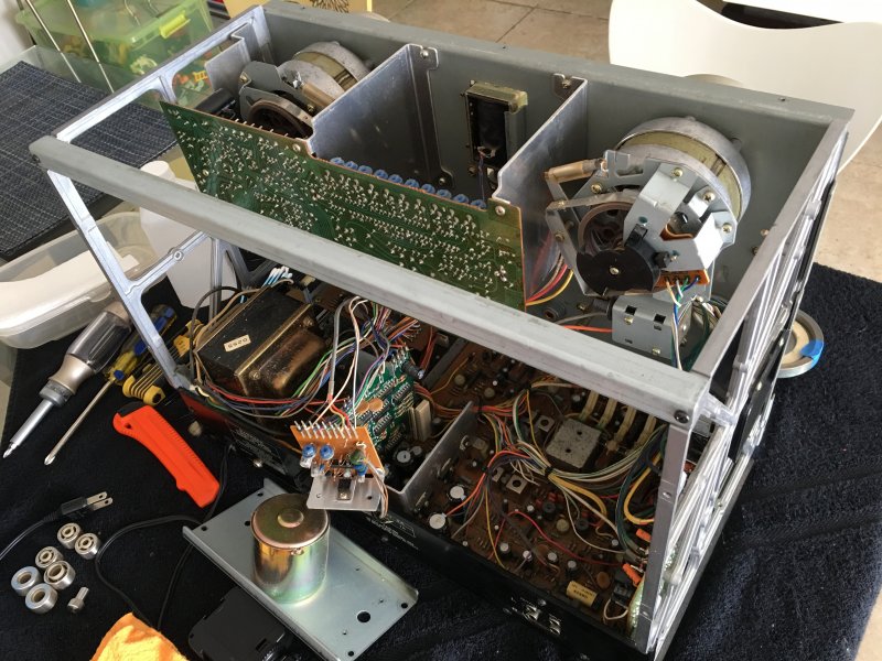

Ok my 909 restore is moving along . All the mechanical and recapping is done. The heads assy is back from JRF and needs to installed. I went over budget, but I had to make some decisions. 1. the upper ball joints were missing ,replaced .2. My playback heads were shot ,replaced with good used (relapped, edged slots , polished and aligned). JRF is a good company they did a nice job and explained everything to me.They also give you all the test reports of your heads. The screws are very soft some heads were already stripped out (capstan motor mount) some were just so tight they stripped. Ace hardware had all but one size (2.6x5mm)which a found at a RC cars hobby shop. I did re flow some solider joints(pre amp) but not all, there were to many IC's and really close joints. I thought I might do more harm then good. Well I will know soon if I have a very expensive paper weight .

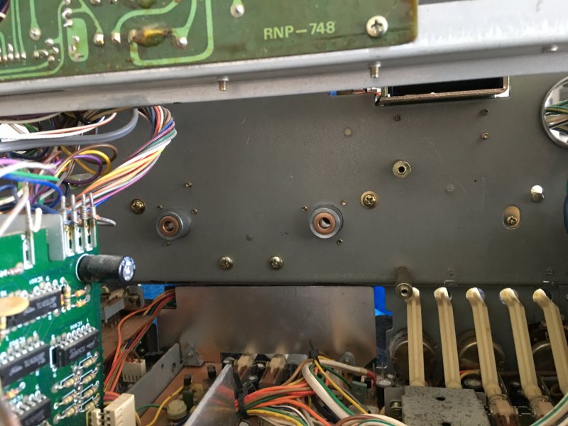

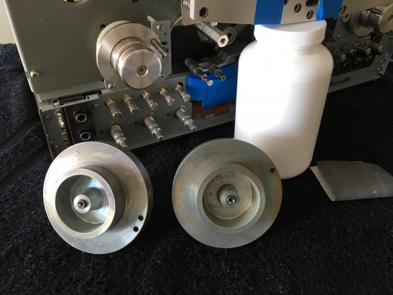

I'm a newbie into the Reel to Reel world and extremely excited to learn everything about this beauty.
I'm doing some basic restoration (if apply) and at the moment I'm deling with some extra parts after removing and replacing the pinch rollers.
I'm following the service manual but the two guys on the right are not shown there.
Are these part of the pinch rollers?
Thanks so much guys.
Those look like 2 out of 3 screw assemblies that hold the flanges to the hub of a metal 10" reel. They are not part of the pinch rollers.

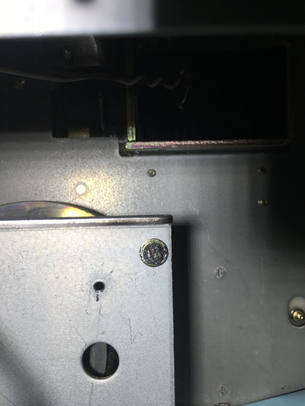

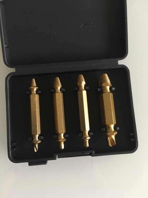

Need some help over here!
I was lucky enough to remove three out of the four screws but the last one (thanks, Good it is located on the upper right side) is giving me some stress.
The screw got stripped and now I'm dealing with the options to remove it correctly. Bought the screw extractor set but is not working as expected.
Any advice would be really appreciated!
UPDATE (2/2/17)
Finally I was able to remove the stripped screw with the Vampliers screw pliers (Vampire tools International) This little tool really did the trick.
