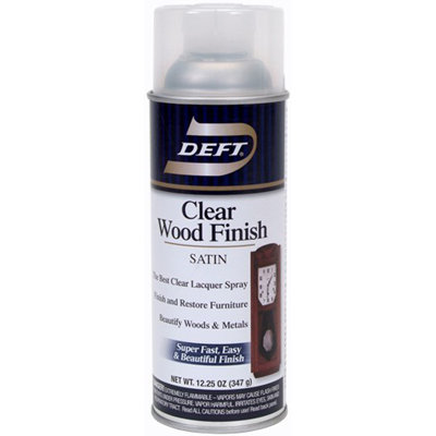

I have a foilcal with some spots that have been rubbed shiny. Can I just spray paint it with satin clear coat to restore the satin finish? (I may try it on some other material as a test, to see what happens.) (And obviously, I would mask the edges and protect the L-pad knob properly.) Thanks!

Here is some satin clear paint or lacquer:
No need to spray a heavy coat. Again Mohawk!!!
They have lacquer spray cans and I would just use a flat and a light dusting to break the shiny spot up.
That means hold the can further away and short burst at the spot only.
I looked at the links but I wasn't sure which specific product you meant, spread out over three different Mohawk categories of paint, each with several subcategories. Plus, the images in those pages are broken for some reason. Do you have one specific product that you recommend? Sorry if I'm being obtuse. :(
By the way I use flat on semi gloss and satin all the time.
If you use semi gloss and did what I instructed you will see little shiny specks. The flat will not do this and will break up the finger rub marks.
You can do this in your kitchen also around the hardware!! Pull the knobs wash with simple green. spray lightly to break up the grab marks put the knobs back on.
I had the same issue.
M102-0421 Tone Finish Clear Lacquer Flat
Or
M102-0451 Ultra® Flo Clear Flat
This is the better of the two

Ok Zonker what I would do here is the outer black paint and the laminate silk screen should look a little different. I would wash it with simple green and then naphtha no hard scrubbing but an even wiping. You're just dissolving the waxes and oils and cleaning the switches let dry and see what you have.
If at that point the silk screen laminate looks fine leave it as is. Mask it off regardless now. The black paint is pebbly looking, crappy paint job. Coat it evenly with the clear flat. Not flooding it,but just a even wet-dry spotty look. See what it looks like when it drys which is fast 10-15 min.
Now unmask the laminate and if you don't like the looks of it mask the switches.
Just a light dusting of the lacquer over it should make it look uniform and not hurt what you did to the painted section.
Look at it as you would install. If you look at it like a tabletop you may never be happy.You know what I mean?
