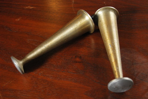

This is the ubiquitous JBL spun aluminum leg:
Designed and built by George Nelson/Herman Miller, it was standard equipment on the C36 and C38 cabinets. A set of these is a nice mod touch for a pair of 60's or 60's-inspired cabinets. Unfortunately, pricing on a full set of eight puts them into the "unobtanium" category for a lot of us.
I'd like to look at some alternatives.

I'm not sure I understand how to attach these legs to the speakers.
Do you build a kind of stand / platform, so legs attached to stand, and JBL speaker sits on this stand? Or what?
In most of these examples, a threaded stud screws into the leg and then into a captive nut in the bottom of the speaker.

Winters, in response to an inquiry I made to the George Nelson museum curator, the JBL legs are a contract specified version of the George Nelson thin edge leg. The specific changes were to make it five inches rather than seven, and change the three screw flange fastening setup to a center threaded stud with no top collar.
You will notice the footer and flare rate to be identical.. BTW, these are from humemodern.com. and still available for purchase. :thmbsp:
