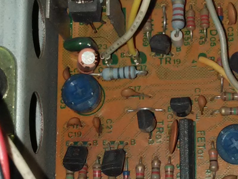

I received 2 Sansui G-5700 Receivers free from my friend and co-worker. 1 is a basket case with considerable damage to the exterior and a few pieces missing inside.:( The second one Powers up but has no sound output. The safely operate light does not light up. The FM Tuner seems to work great as far as I can tell. The protection relay does not click on.:( It appears as though someone has done some work on the R side of the F-2980 board and on the R Output. The picture above show these repairs. I'm hoping someone here can help me get this thing firing on all cylinders. Sorry guys I work at a car parts store so, I had to make a silly pun. Also if any users are from OKC area I would like some hands-on guidance if possible???

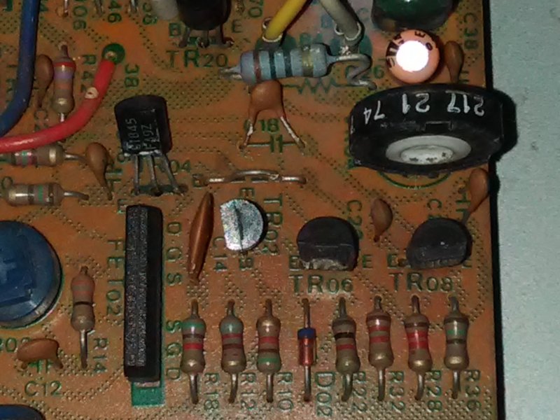

In the first photo is that the 21 turn pot. that everyone is suggesting?
Well, it has '21' painted on it, but that looks like a date code or batch number, probably not a descriptor of the part itself. If that is an original part, (it looks a bit weird), then it will very likely be a single turn trimmer resistor. BTW: What is everyone suggesting?
No its not original. This is what it should be.
Yes, the small round blue ones are the original 100Ω, single turn trimmers. I don't recognize the large one with the "21" markings.

Yes the trimmer and the extra resistor on the audio output in the pictures are on the good board.

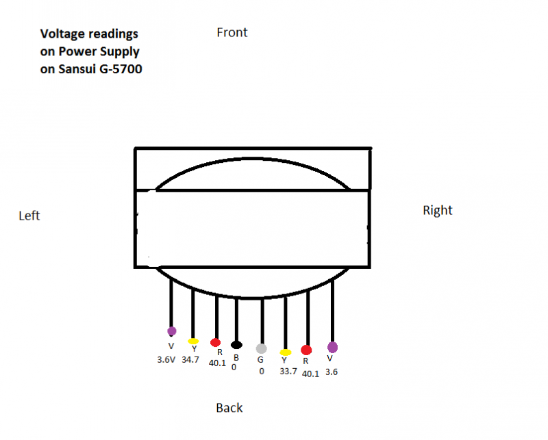

Also did some voltage checks on the power supply and got, I could use some direction on this Ghazzer. Where should I start looking?
OK. What do you think of your voltage readings? Did you measure the line voltage for a reference?
First, I recommend that you use mini-grabbers with your DMM. Connect the grabbers with power off, give everything a visual check, then apply power to get your readings. These readings will be a little lower than expected if you are using a DBT.
There are several places in the P/S where voltages are marked on the schematic. I would check those next.
Note that there are two circled numbers (5 & 6) coming off the filter caps, just above and to the left of the F-2868, Speaker Selector. These are the rail voltages: 5 = +54vdc & 6 = -54vdc. From the filter caps they are routed to every place where you see the circled 5 or 6.
Voltage levels wrt ground are marked at several places in the right channel and should be the same in the left chanel.
