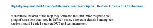

made up some specially wired test leads per the guidance of the audio precision book “audio measurements handbook” page 66
The RCA's are Canare F-09 Narrow Profile plugs. They aren't quite as narrow(needed for connecting to vintage gear like Scott 299, Pioneer SX9000 etc) as the Rean Silver connectors I have for the other analyzer but the strain reliefs are nice for constant movement. Half of this set is used to go back to the Analyzer from RCA jacks on preamps, so I still need to make another pair of cables for connecting to power amps. I used to connect to my dummy load with BNC's but after that stuff Ray Gianelli found about connecting the analyzer leads directly at the DUT output I'm going to go that route.
