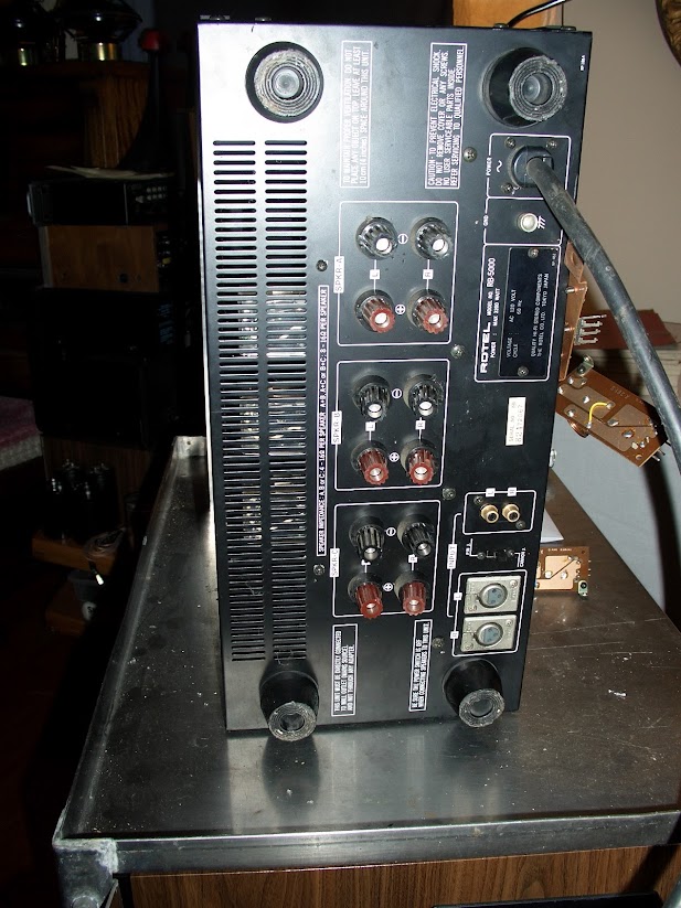

Saw a blown 8A fuse and found 7/10 blown outputs on one side. 1/2 of that side (upper/lower cycle amp setup) is almost completely toast. Most of the resisters are out.
Talk is a repair and complete re-cap. We're starting with all new outputs. (MJ15022G/MG15023G).
The amp block reminds me of a Borg Cube.
20 outputs.
Makes that Bose 1800 I did a little while back look like a toy.
Looks like a beast of a power supply. I'm assuming the larger of the cans are dual torroidal transformers for dual mono? And the main filter caps...22000uF at 120V...(even the 4 470uFs rated at 160V). What are the rails designed for, 100V or so? Either one of those 470s was really poorly sleeved, or there's some serious heat issues in there even with the fan. I like the added touch of feet on the rear panel so you can stand it up and work on the bottom boards.

This has factory wheels on the bottom towards the back!
That clamp is the only one on the four and uses the cap can as a board mount on that side.
Recapping that means I have to restuff to keep the can as a mount!
