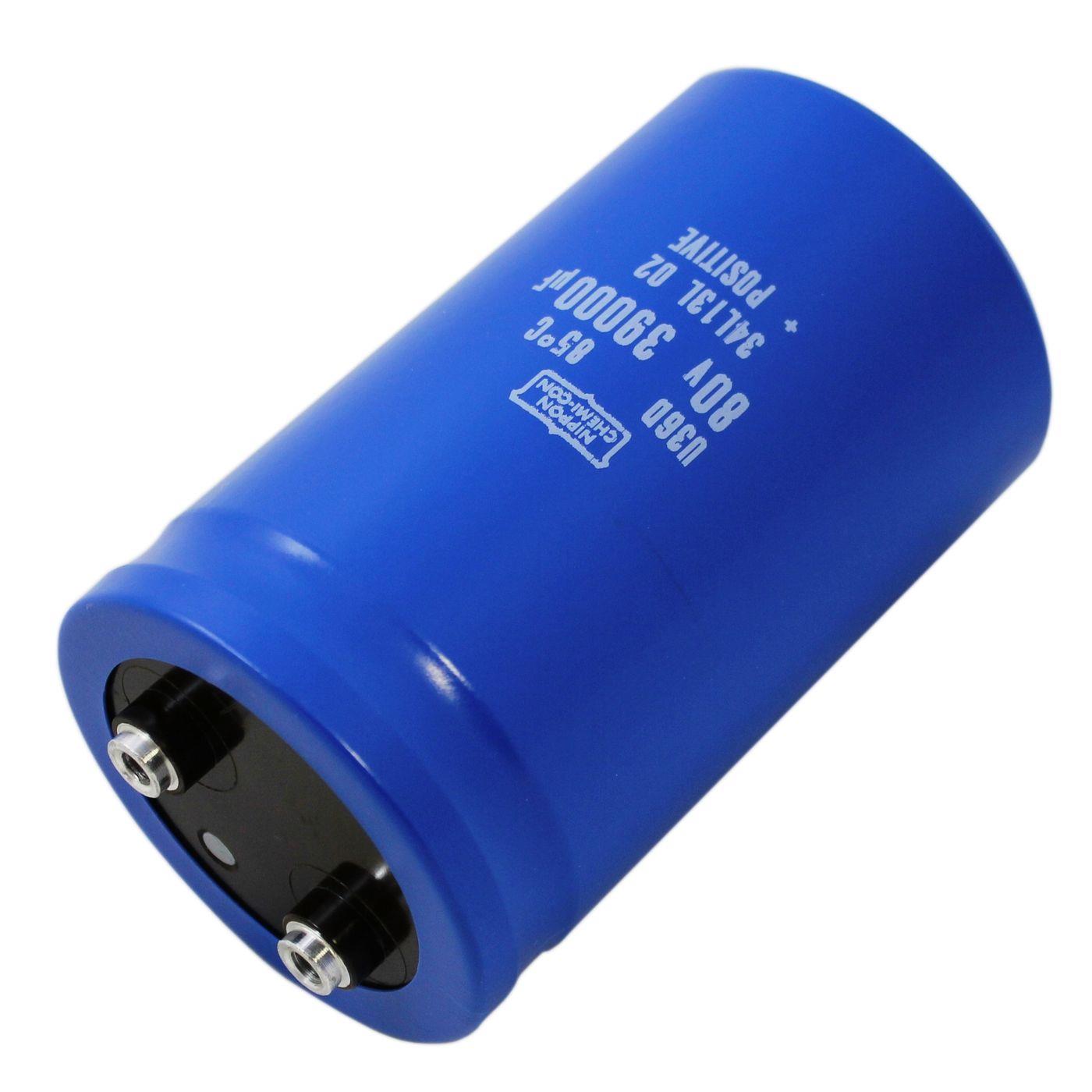

were measured it electrically and with dimmensions. I needed to know what biggest caps I can put inside. I decided to use 4 x 39000 uF Nippon caps.

You upped the inrush diodes value for the bigger mains caps, yes?
No, in this Rotel everything is oversized. Main power supply voltage is about 65V, main capacitors are rated 100V, diode briges are BR154: 400V DC, 280Vrms and
Peak Forward Surge Current 300A , Average Forward Rectified Current 15A.
15A average with this voltage give me about 1000VA, the same are transformers value and 300A peak is enough to protect BR with even bigger caps.
Do you think that I need to change it ?? In my opinion, no.
Maybe not in this one. I had this amplifier back when it was only about 9 years old, along with the active preamp.
I mentioned because it is often considered good practice to up the rating on those when going above 10% higher mains cap value.
I was surprised with all parts inside. I renewed few Luxman and Accuphase constructions and always voltage rating on caps was to low to safetly work in Europe. Always works few volts above limit ( 66 V in 63 V limit line , 74 V in 71 V line, etc ). The same with diodes ratings almost on limit. Here all limits are much higher.
I should have 230V AC but with fuc.... photovoltaic instalation all around in sunny day I have about 250 - 250 V AC in line and this measured about 65 V on main in Rotel is in this worster AC condition, today ( cloudy winter weather) is few volts lower inside RHB10.
