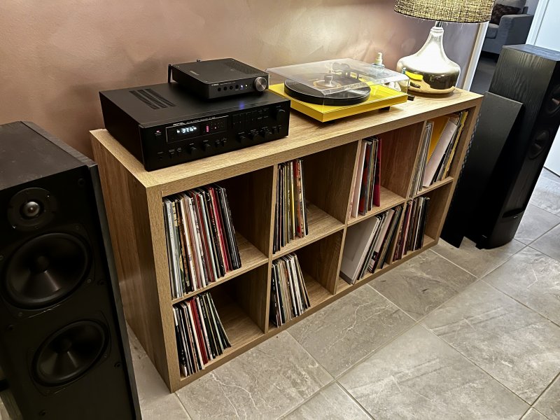

I like this one! Not the last word on stereo imaging. Truth told that aspect is not good. BUT it's very punchy, eager and confident. This is an amp that's here to step up and do the work, and it hasn't broken a sweat yet. A super clear amp that sorts out every instrument very well. Good tuner too. If you were to find the seperate power amplifier they marketed to go with this (RB-850) you'd be in great shape. I have it working with a Yamaha WXC-50 pre and Boston Acoustics VR1 (yeah I know but I sorted them out with some Morel 448 tweeters).
